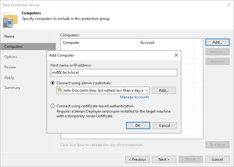

At the Computers step of the wizard, specify computers that you want to add to the protection group.
To add a computer to a protection group:
  1. Click Add.
  2. In the Add Computer window, in the Host name or IP address field, enter a full DNS name, NetBIOS name or IP address of the computer that you want to add to the protection group.
  3. Select a method to connect to the computer:
  • Connect using admin credentials. In this case, from the Credentials list, select a user account that has administrative permissions on the computer that you want to add to the protection group. Veeam Backup & Replication will use this account to connect to the protected computer and perform the necessary operations on the computer: upload and install Veeam Agent, and so on.
If you have not set up credentials beforehand, click the Manage accounts link or click Add on the right to add credentials.

  • [For Linux computers] Connect using certificate-based authentication. Select this option, if you chose to pre-install Veeam Deployer Service on the Linux computer that you want to add to the protection group. In this case, Veeam Backup & Replication will communicate with the Linux computer using a certificate. Veeam Backup & Replication will install Transport Service that will be used to perform the necessary operations on the computer: upload and install Veeam Agent, and so on. To learn more, see Deploying Veeam Agent for Linux Using Pre-Installed Veeam Deployer Service.
