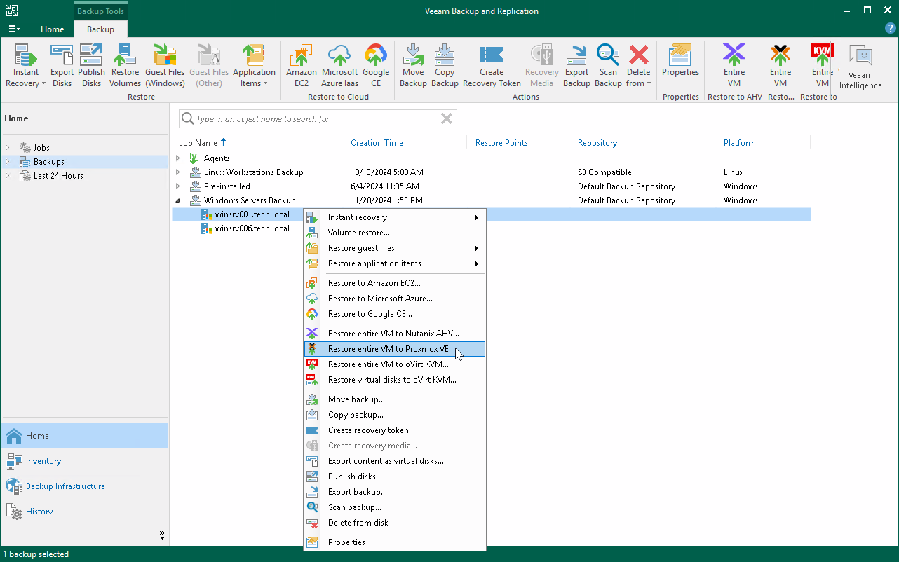

You can use the Veeam Backup & Replication console to restore a Veeam Agent computer as a Proxmox VE VM in your virtualization environment.
If you restore a Veeam Agent computer to a Proxmox VE VM, consider the following:
  • You can use backups of Microsoft Windows and Linux computers stored in a Veeam backup repository only. You cannot perform this operation with Veeam Agent backups stored in a Veeam Cloud Connect repository.

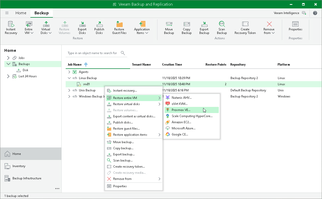

Restore to Proxmox VE
The procedure of restore to Proxmox VE for a Veeam Agent computer practically does not differ from the same procedure for a VM. To learn more about restore to Proxmox VE, see the Performing VM Restore section in the Veeam Backup for Proxmox VE User Guide.
