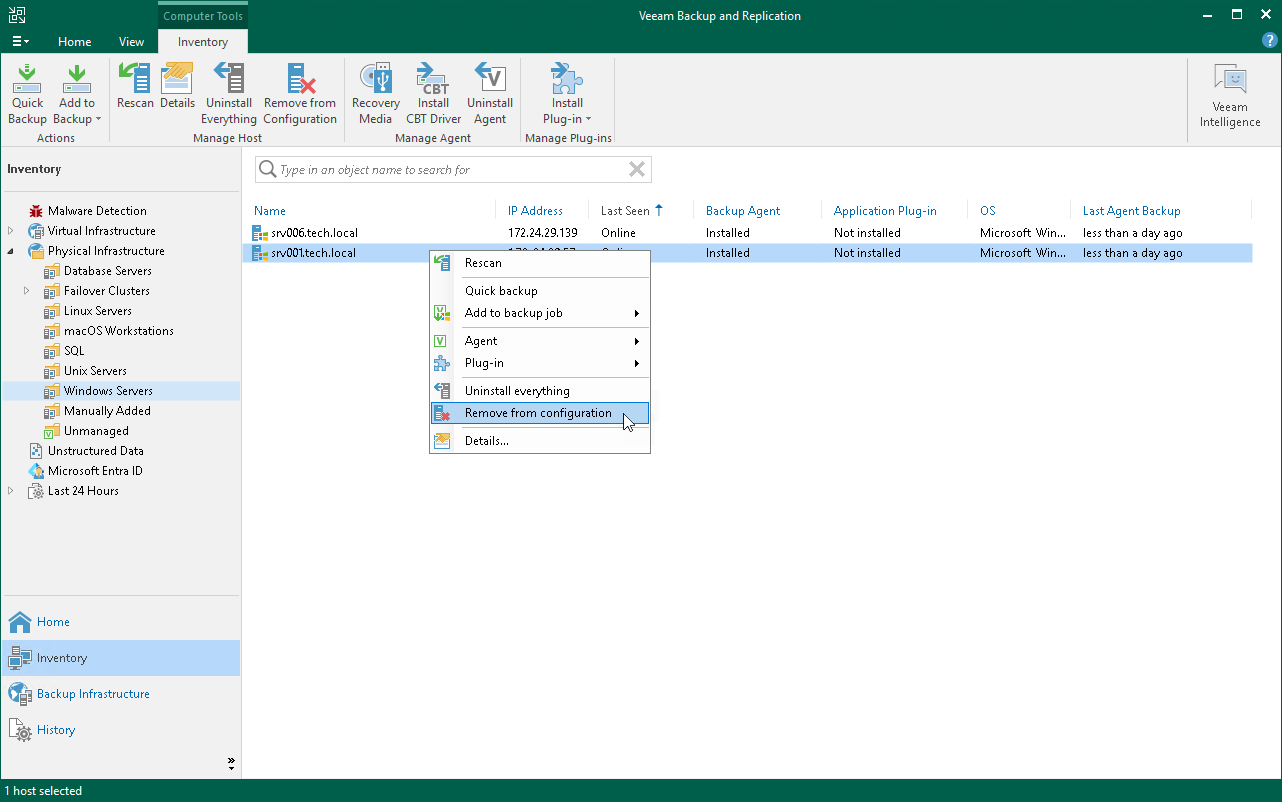

To remove a computer from a protection group:
- Open the Inventory view.
- In the inventory pane, expand the Physical Infrastructure node and select the necessary protection group.
- In the working area, select the necessary computer and click Remove from Configuration on the ribbon or right-click the computer and select Remove from configuration.
Backups created for computers that were removed from a protection group remain intact in the backup location. You can delete this backup data manually later if needed.
You cannot remove a computer from the protection group if this computer is a failover cluster node. |
