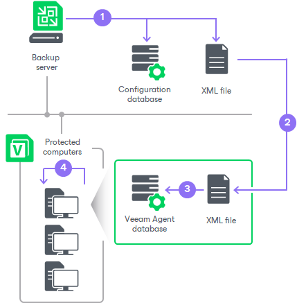

In the scenario where you use the backup policy to create Veeam Agent backups, Veeam Backup & Replication and Veeam Agents interact in the following way:
  1. When you create a backup policy, Veeam Backup & Replication saves the backup policy settings in the following locations on the backup server:
  • In the Veeam Backup & Replication database.
  • In the configuration file of the XML format.
  1. Once the backup policy is created, Veeam Backup & Replication immediately applies the backup policy to Veeam Agents that run on protected computers.
  1. Veeam Backup & Replication reads the list of computers and protection groups specified in the backup policy and starts the discovery process for these computers.
  2. During the discovery process, Veeam Backup & Replication connects to each computer in the backup policy and uploads the XML file with backup policy settings to the target computer.
  1. Veeam Backup & Replication uses settings from the backup policy to configure the Veeam Agent backup job. This process differs depending on what OS and Veeam Agent the protected computer runs.
  • On Microsoft Windows computers, Veeam Backup & Replication creates the Veeam Agent backup job using the Veeam Agent for Microsoft Windows Configurator.
  • On Linux computers, Veeam Backup & Replication creates the Veeam Agent backup job using the Veeam Agent for Linux command line interface.
  • On Unix computers, Veeam Backup & Replication creates the Veeam Agent backup job using the Veeam Agent command line interface.
Settings of the created backup job are saved to the Veeam Agent database on the protected computer.
Veeam Backup & Replication regularly applies the backup policy to protected computers during rescan of protection groups added to the backup policy. To learn more, see Backup Policy Application Methods.
  1. The created Veeam Agent backup job runs on the protected computer in the similar way as a regular Veeam Agent backup job configured directly on the Veeam Agent computer. To learn more, see the following sections:
Every 6 hours, Veeam Agent checks whether job settings obtained from the backup policy are up-to-date and do not differ from the current backup settings specified in the backup policy. If the settings differ, Veeam Agent updates backup job settings in its database. To learn more, see Backup Policy Application Methods.

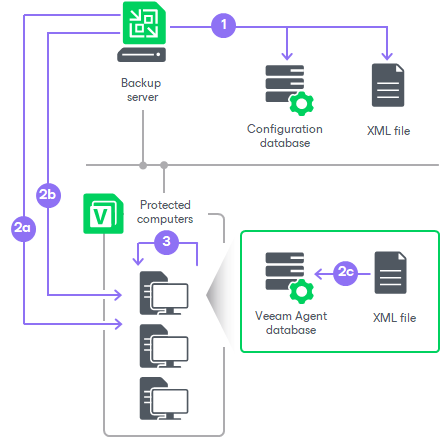

In the scenario where you use the backup policy to create Veeam Agent backups on Veeam Agent computer included in a protection group for pre-installed Veeam Agents, Veeam Backup & Replication and Veeam Agents interact in the following way:
  1. Veeam Agent connects to Veeam Backup & Replication and gets the configuration file.
Backup Policy IMPORTANT
Veeam Agent does not connect to Veeam Backup & Replication immediately after updated backup policy settings are saved. Veeam Agent checks whether Veeam Backup & Replication has any updates in the backup policy settings periodically. As a result, a time period between scenario steps 1 and 2 may take up to 6 hours. If necessary, you can synchronize Veeam Agent with Veeam Backup & Replication running a command from the Veeam Agent computer. To learn more, see Backup Policy Application Methods.
  1. Veeam Agent uses the backup policy settings from the configuration file to create a Veeam Agent backup job. Settings of the created backup job are saved to the Veeam Agent database on protected computer.
