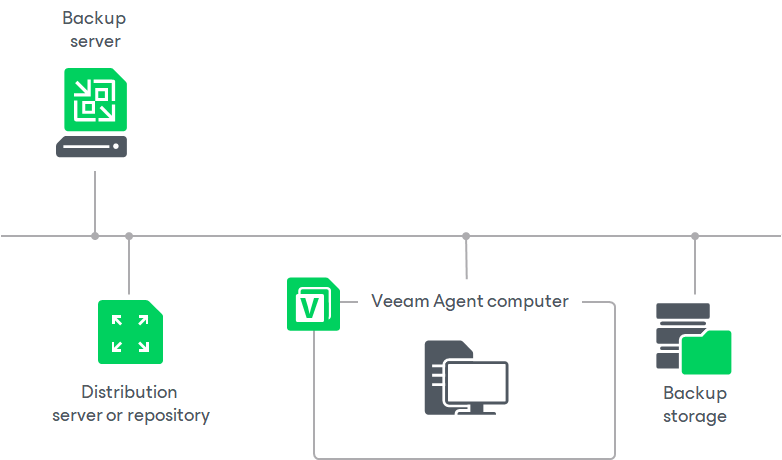

Distribution Server
The distribution server is an architecture component in the Veeam Agent management infrastructure used for automated deployment of Veeam Agent setup files to protected computers. When you instruct Veeam Backup & Replication to install Veeam Agent on a protected computer, the Veeam backup server communicates to the distribution server, and Veeam Backup & Replication uploads Veeam Agent setup file from the distribution server to the target computer.
By default, the role of the distribution server is assigned to the backup server itself. However, you can deploy a dedicated distribution server to reduce load on the backup server. To deploy a distribution server, you need to add a Windows-based server to Veeam Backup & Replication. To learn more, see the Adding Microsoft Windows Servers section in the Veeam Backup & Replication User Guide. After you assigned the role of distribution server, you need to select this server in the properties of a protection group. To learn more, see Step 4. Specify Discovery and Deployment Options.
A machine performing the role of the distribution server must meet the following requirements:
  • The role of the distribution server can be assigned to a physical or virtual machine.
  • The machine must run a 64-bit Microsoft Windows OS.
  • You must add the machine to the Veeam Backup & Replication console as a managed server.

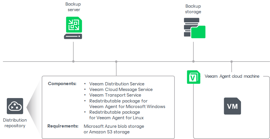

The distribution repository is an architecture component in the Veeam Agent management infrastructure used for automated deployment of Veeam Agent setup files to cloud machines. When you instruct Veeam Backup & Replication to deploy Veeam Agent on a cloud machine, the Veeam backup server communicates to the distribution repository, and Veeam Backup & Replication uploads Veeam Agent setup file from the distribution repository to the target cloud machine using signed URLs. To learn how Veeam Backup & Replication communicates with Veeam Agents installed on cloud machines, see Backup of Cloud Machines.
The role of the distribution repository must be assigned to a dedicated object storage repository. To do this, you need to add a Microsoft Azure blob storage or Amazon S3 storage to your infrastructure depending on the type of cloud machines you plan to protect. To learn more, see the Adding Azure Blob Storage or Adding Amazon S3 Storage sections in the Veeam Backup & Replication User Guide.
Consider the following:
  • You can store backups of cloud machines only in the object repository located on the same external cloud storage as the cloud machines you want to back up.
  • [For Azure Blob Storage] If you plan to use the Azure Blob Storage repository as a distribution repository, you must add this repository using a general-purpose v2 storage account. Other account types are not supported.
  • [For Azure Blob Storage] You cannot add a repository using the Microsoft Entra ID account.
  • [For Amazon S3 Storage] If you plan to use the Amazon S3 repository in the China region as a distribution repository, make sure that you have the ICP license. This license is required to create signed URLs for Amazon S3 repositories in the China region. For more information, see AWS Documentation.
