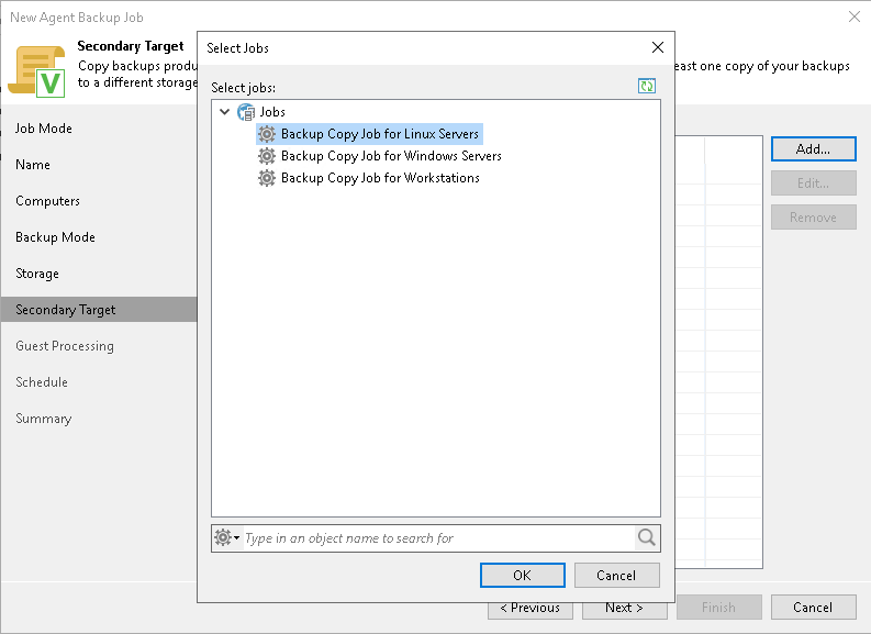

To link jobs:
  1. Click Add.
  2. From the jobs list, select a backup to tape or backup copy job that must be linked to the Veeam Agent backup job. You can link several jobs to the backup job  — for example, one backup to tape job and one backup copy job. To quickly find the job, use the search field at the bottom of the wizard.
