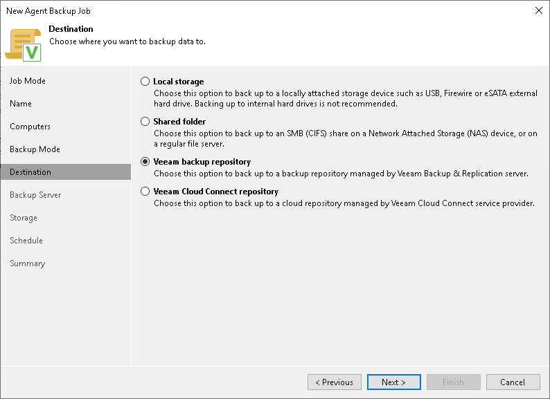

Step 7. Select Backup Destination
At the Destination step of the wizard, select a target location for backups created by Veeam Agents installed on protected computers.
You can store backup files in one of the following locations:
  • Local storage — select this option if you want to save a backup on a removable storage device attached to a protected computer or on a local drive of a protected computer. With this option selected, you will pass to the Local Storage step of the wizard.
Step 7. Select Backup Destination IMPORTANT
It is recommended that you store backups in the external location like USB storage device or network shared folder. You can also keep your backup files on the separate non-system local drive.
  • Shared folder — select this option if you want to save a backup in an SMB network shared folder. With this option selected, you will pass to the Shared folder step of the wizard.
  • Veeam backup repository — select this option if you want to save a backup in a backup repository managed by a Veeam backup server. With this option selected, you will pass to the Backup Server step of the wizard.
  • Veeam Cloud Connect repository — select this option if you want to save a backup on a cloud repository exposed to you by the Veeam Cloud Connect service provider. With this option selected, you will pass to the Storage step of the wizard.
