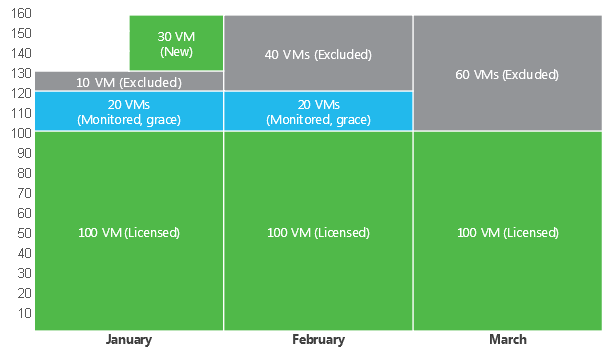

Consider the following example. Veeam ONE uses a Rental license with the license auto update disabled and the expiration date set to 60 days from the license issue date. At the beginning of January the number of VMs is 130, while a license covers 100 VMs. The period for exceeding the license limit is 60 days. Within the first 60 days (in January and February), Veeam ONE will manage 100 + 20 VMs that were discovered first (license limit + 20%). 10 VMs that were discovered last will be excluded from monitoring and reporting. In addition, in the middle of January, Veeam ONE discovers 30 new VMs. Veeam ONE will manage these VMs until the end of the month.
If the license is not updated and the license limit is not increased, Veeam ONE will exclude from monitoring and reporting:
  • 30 VMs that exceed the license limit
  • 30 VMs that were discovered in January
