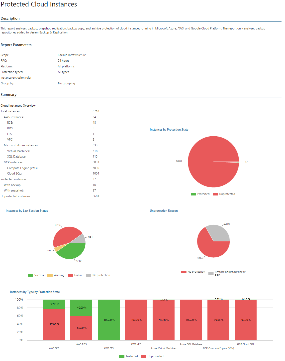

  • The Summary section includes the following elements:
    • The Instances by Protection State chart shows the number of protected and unprotected cloud instances.
    • The Instances by Last Session Status chart shows status of the latest job session for discovered cloud instances.
    • The Unprotection Reason chart shows reasons for non-compliance with the specified RPO requirements.

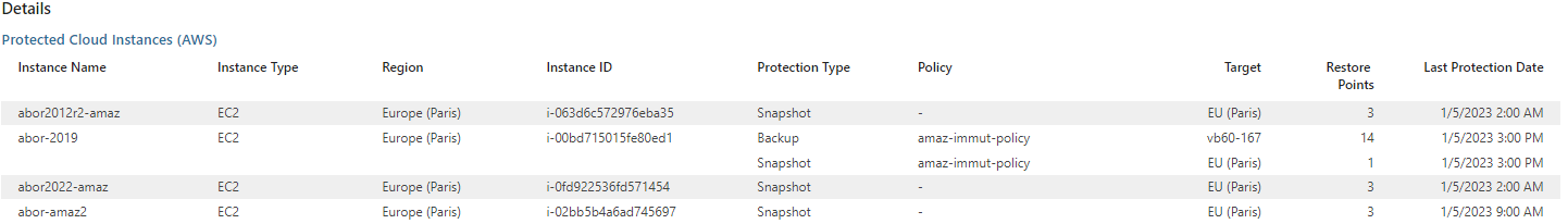

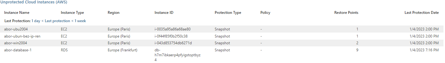

  • The Details section provides information on all protected and unprotected cloud instances including instance ID, protection type, policy name, backup, snapshot, replication, backup copy or archive protection target, number of available restore points and date and time of the latest backup, snapshot, replication, backup copy or archive protection.
