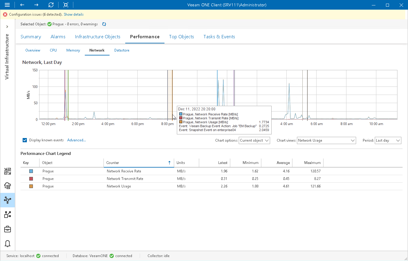

  5. At the bottom of the performance chart, select the Display known events check box.
  6. To choose what type of events to show on the performance chart, click the Advanced link next to the Display known events check box, and select the necessary events.
View Events on Performance Charts

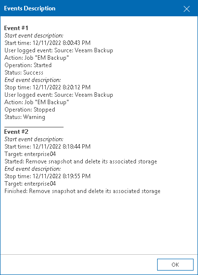

Events are shown as vertical lines crossing the performance graphs. To learn more about an event, hover the mouse cursor over it to see a tooltip, or click the line in the graph. The Events Description window will provide detailed information about the event.
