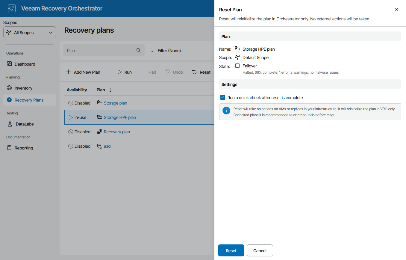

- Select the plan. From the Manage menu, select Reset.
-OR-
Right-click the plan name and select Manage > Reset.
- Complete the Reset Plan wizard:
- For security purposes, at the Enter Credentials step, retype the Orchestrator Administrator, Plan Author or Plan Operator password.
- At the Quick Check step, select the Perform a Quick Check after reset is complete check box to run a readiness check to confirm that the changes are valid.
- At the Summary step, review configuration information and click Finish.
