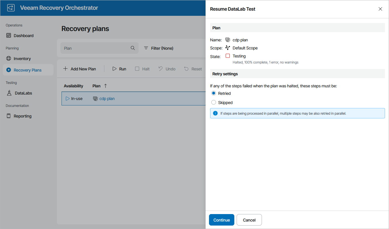

To start the HALTED storage plan testing process:
- Log in to the Orchestrator UI as an Orchestrator Administrator, Plan Author or Plan Operator. For more information, see Accessing Orchestrator UI.
- Navigate to Orchestration Plans.
- Select the plan. From the Verify menu, select Continue DataLab Test.
-OR-
Right-click the plan name and select Verify > Continue DataLab Test.
- Complete the Resume DataLab Test wizard:
- At the Resume Test step, select an option to resume test execution.
Choose whether you want to proceed with test execution from the next plan step or to retry the failed step.
- At the Summary step, review configuration information and click Finish. The testing process will be started.
