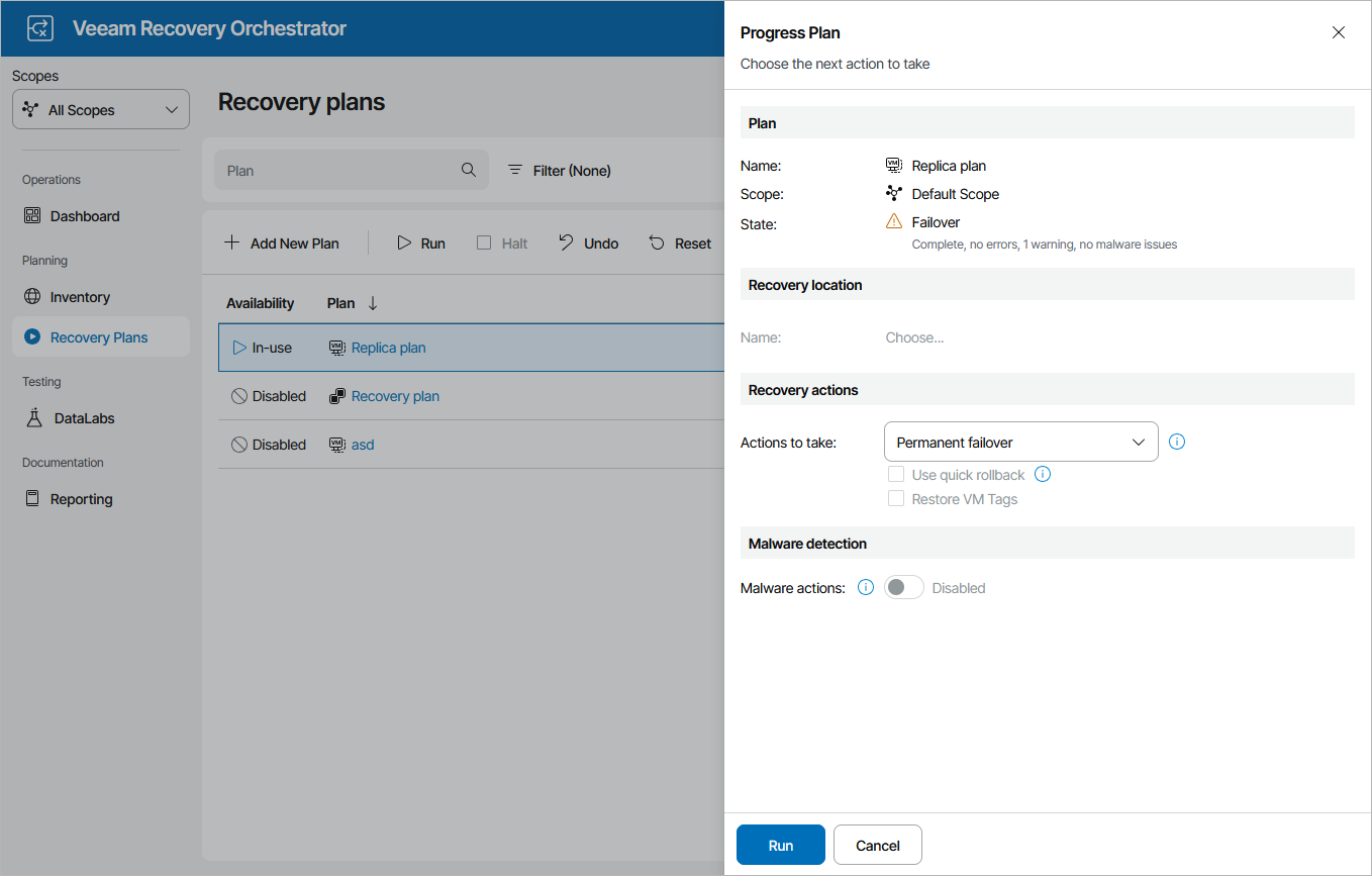

- Complete the Run Plan wizard:
- For security purposes, at the Enter Credentials step, retype the Orchestrator Administrator or Plan Operator password.
- At the Progress Plan step, select the Permanent Failover option.
- At the Summary step, review configuration information and click Finish.
