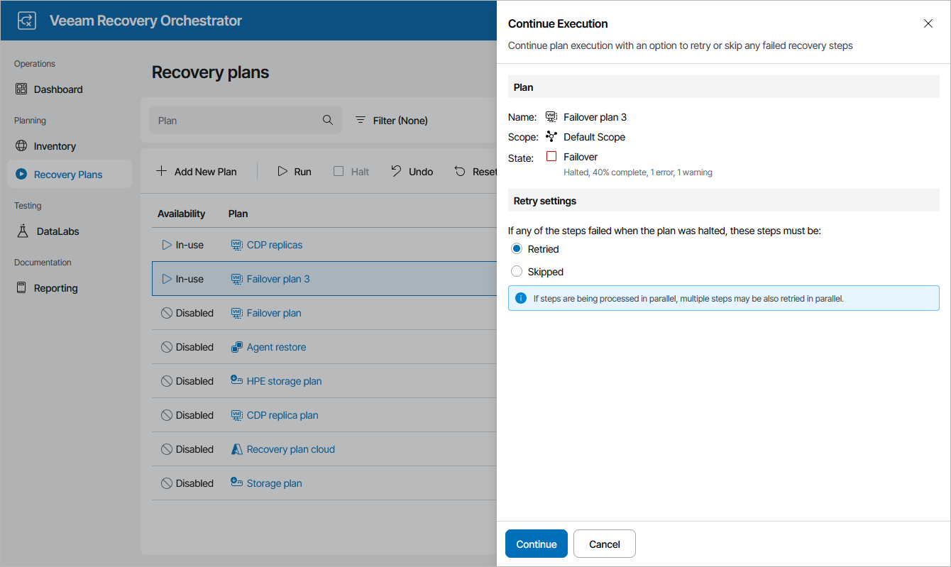

To run a HALTED cloud plan:
  2. Select the plan. From the Launch menu, select Continue.
-OR-
Click the plan name to switch to the Plan Details page, and click Continue.
  1. Complete the Run Plan wizard:
  1. For security purposes, at the Credentials step, retype your password.
Running Halted Restore Plan
  1. At the Resume Settings step, select an option to resume plan execution.
Choose whether you want to proceed with plan execution from the next plan step or to retry the failed step.
  1. At the Summary step, review configuration information and click Finish. The restore process will be started.
