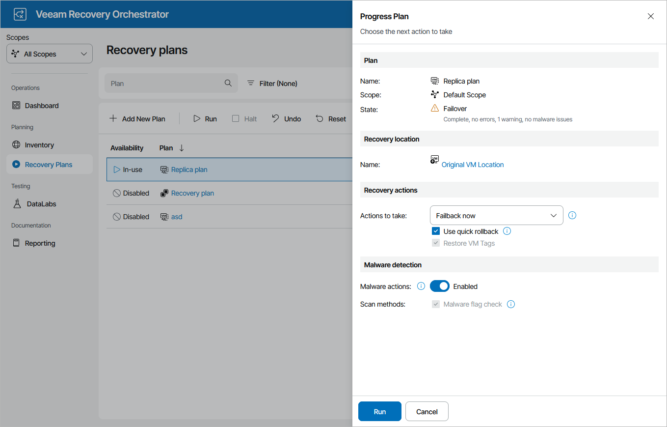

To commit failback for a plan in the FAILBACK state:
- Log in to the Orchestrator UI as an Orchestrator Administrator or Plan Operator. For more information, see Accessing Orchestrator UI.
- Navigate to Orchestration Plans.
- Select the plan. From the Launch menu, select Continue.
-OR-
Click the plan name to switch to the Plan Details page, and click Continue.
- Complete the Run Plan wizard:
- For security purposes, at the Enter Credentials step, retype the Orchestrator Administrator or Plan Operator password.
- At the Commit Failback step, review the description of the commit failback process.
- At the Summary step, review configuration information and click Finish.
