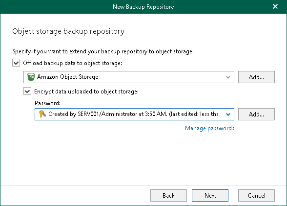

Step 4. Specify Object Storage Repository
At this step of the wizard, you can optionally extend a backup repository with object storage to back up data directly to the cloud. For more information about object storage, see Object Storage Repositories.
If you do not want to use object storage as your backup repository, skip this step and click Next.

To extend a backup repository with object storage, do the following:
- Select the Offload backup data to object storage check box.
- From the drop-down list, select an object storage repository to which you want to offload your data.
Make sure that an object storage repository has been added to your environment in advance. Otherwise, click Add and follow the steps of the wizard. For more information on how to add an object storage repository, see Adding Object Storage Repositories.
- To offload data encrypted, select Encrypt data uploaded to object storage and provide a password.
If you have not created a password beforehand, click Add or use the Manage passwords link to specify a new password.
A password can be changed in the Password Manager at any time. A password change does not impose any restrictions on accessing existing backup data in object storage.
