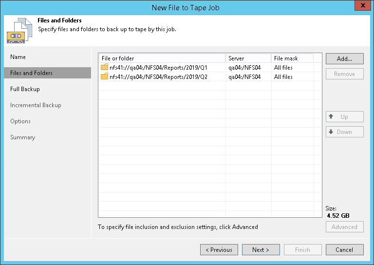

At the Files and Folders step of the wizard, select files and folders that you want to back up.
  1. Click Add.
  2. From the Server drop-down list, select a data source where the necessary files or folders reside:

  1. In the Folders tree, select folders you want to backup.
To select multiple folders, hold [Ctrl] and click necessary folders. Although different folders of the same share form separate records in the table, they will be processed by one job task.

  1. In the Files and Folders screen, use the Up and Down buttons on the right to move sources up or down. The sources of the job are processed in the order in which the list displays them.

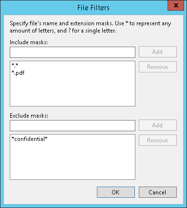

If you add a folder to the job, all the folder contents will be processed. If necessary, you can choose only specific files from the added folder. To do so, select a folder in the list and click Advanced. In the File Filters window, use Include masks and Exclude masks fields to filter the folder contents. You can use exact file names or create name masks (for example, *.EVT or *.PDF).
