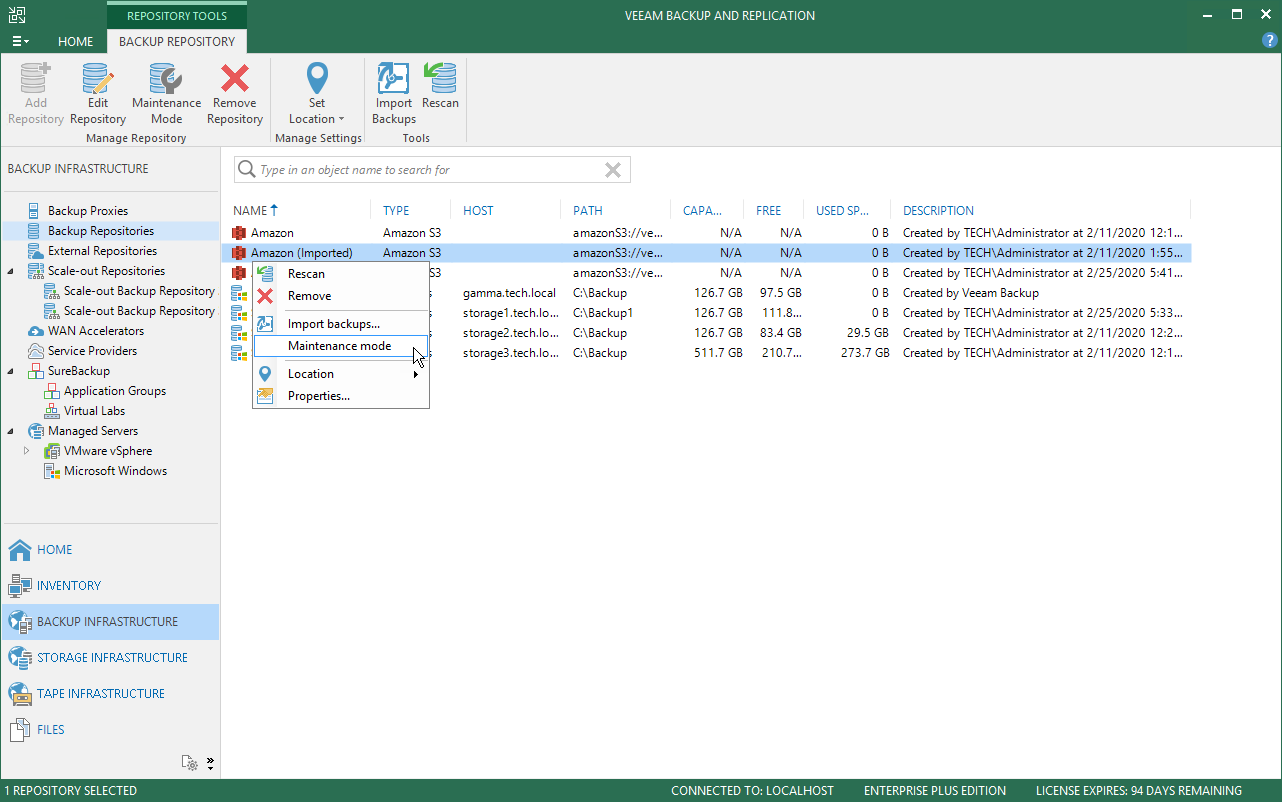

To put an object storage repository into maintenance mode, do the following:
- Open the Backup Infrastructure view.
- In the inventory pane, select the Backup Repositories node.
- In the working area, select an object storage repository and click Maintenance mode on the ribbon or right-click an object storage repository and select Maintenance mode.
To switch back to normal, repeat steps 1 and 2, and at the step 3, click the Maintenance mode button once again or clear the Maintenance mode check box.
