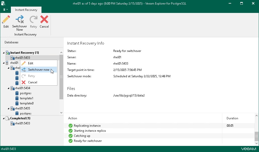

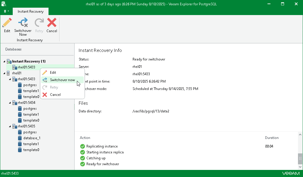

To start switchover manually, do the following:
  1. In the navigation pane, under the Instant Recovery node, select a published instance.
  2. On the Instant Recovery tab, select Switchover now.
Alternatively, you can right-click the instance and select Switchover now.
