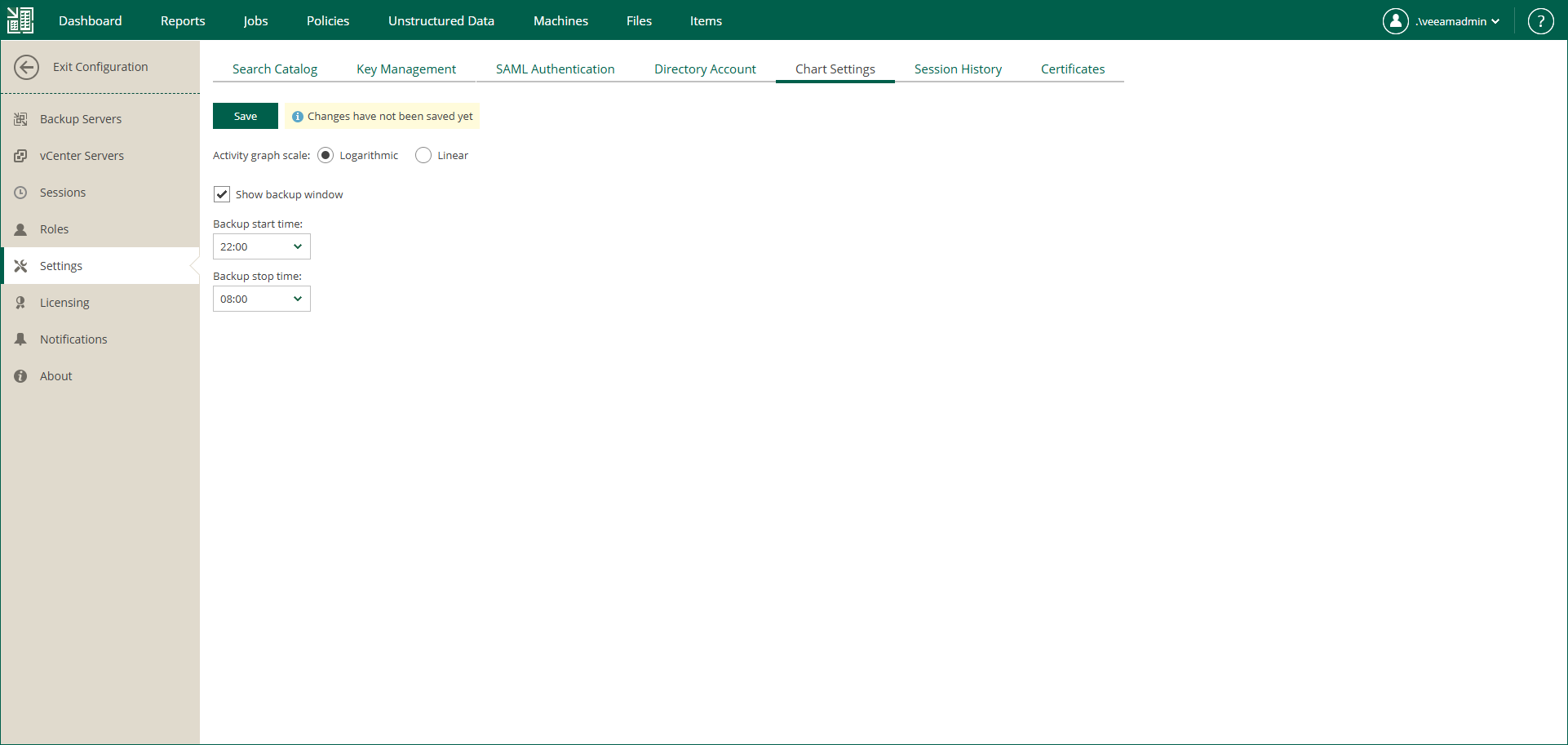

To customize the appearance of the chart, do the following:
  1. Log in to Enterprise Manager using an account with the Portal Administrator role.
  2. In the upper-right corner, click Configuration.
  3. Select the Settings section on the left of the Configuration view.
  4. Select the Chart Settings tab.
  5. Use the Activity graph scale options to switch between graph types: Linear and Logarithmic.
  6. Select the Show backup window check box to highlight the backup window on the dashboard chart.
  7. Specify time interval for the backup window. Default interval is from 8:00 PM to 8:00 AM. You can change the interval to correlate with your planned backup window by editing the start and stop time.
  8. To save the changes, click Save.
