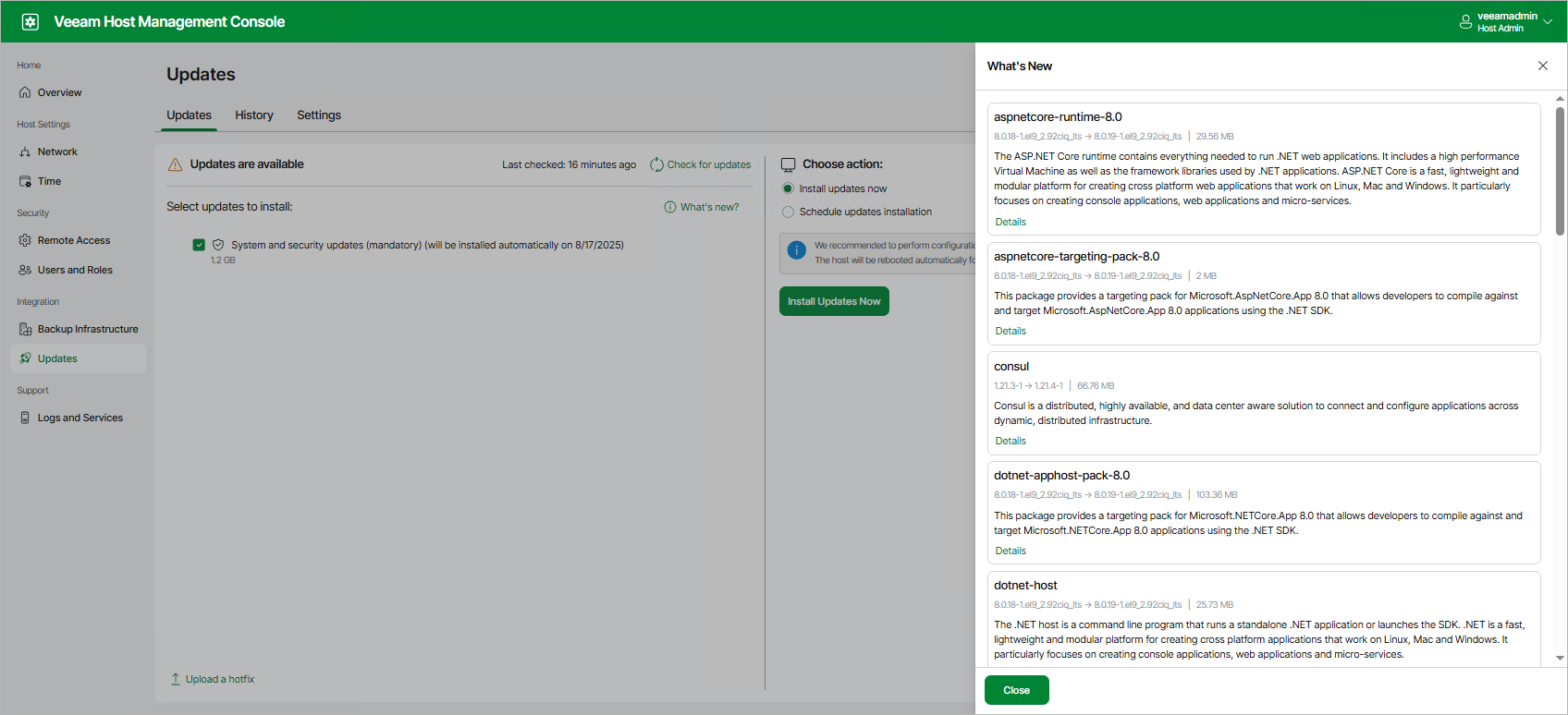

Installing Updates Manually
To install updates manually, perform the following steps:
  1. Log in to the Veeam Host Management console installed on Veeam Backup Enterprise Manager.
  2. In the management pane, click Updates.
  3. On the Updates tab, select updates that you want to install. To view detailed information about changes included in updates, click What's new?. For optional updates, a license agreement is also displayed if applicable.
  4. Select the action:
  • To install updates immediately, click Install Updates Now and confirm the operation.
  • To schedule update installation, set up the schedule and click Schedule Updates.

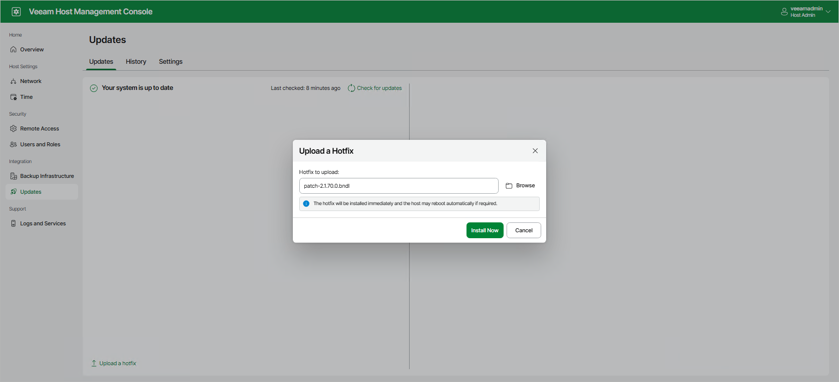

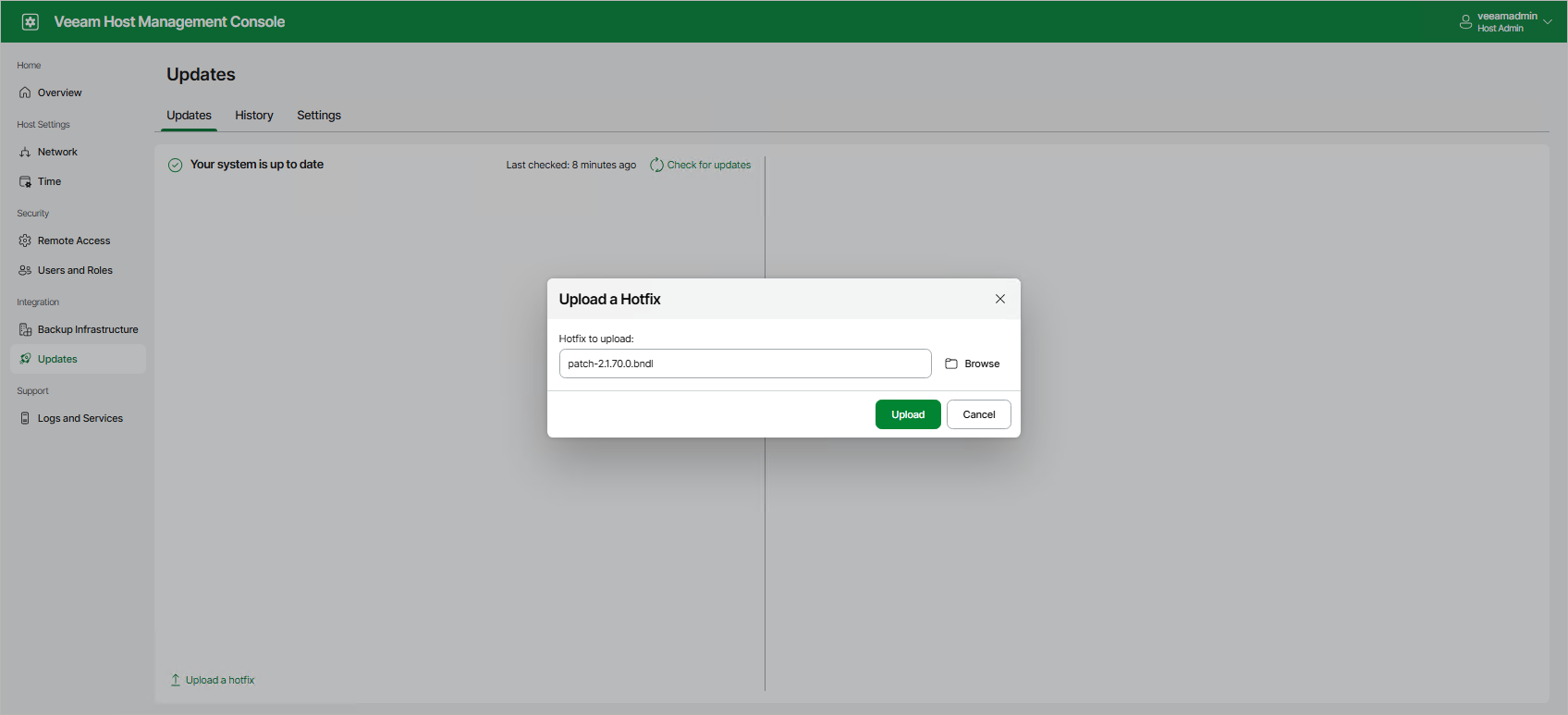

Installing Private Hotfixes
If you get a private hotfix provided by Veeam, you can install it manually. To do this, perform the following steps:
  1. Make sure that you do not have running jobs. Otherwise, recovery operations performed by these jobs will fail.
  2. Log in to the Veeam Host Management console installed on Veeam Backup Enterprise Manager.
  3. In the management pane, click Updates.
  4. On the Updates tab, click Upload a hotfix.
  5. Select the file and click Upload.
Installing Updates
  1. After the file is uploaded, click Install Now. If a hotfix has a license agreement, you need to agree with it before the installation process starts.
