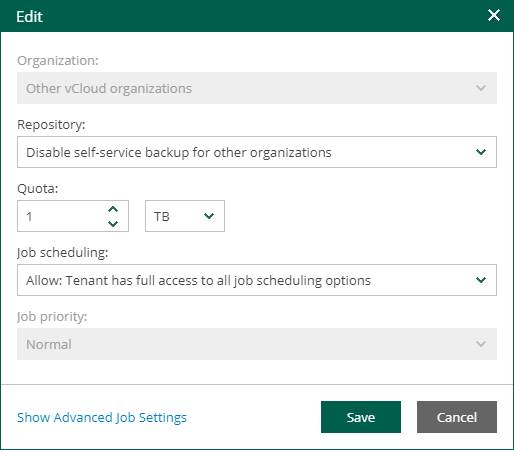

Veeam Backup Enterprise Manager offers a default configuration that you can use for Cloud Director organizations. The configuration is applied to each organization that does not have a specific configuration added for it.
The default configuration contains the following parameters:
  • Organization — Other VMware Cloud Director organizations
  • Repository — Disable self-service backup for other organizations
Initially the default configuration is not active. To enable it, select a repository for the configuration.
  • Quota — 1 TB
  • Job scheduling — Allow: Tenant has full access to all job scheduling
  • Job priority — Normal
For more information on configuration parameters, see Adding Organization Configuration.
