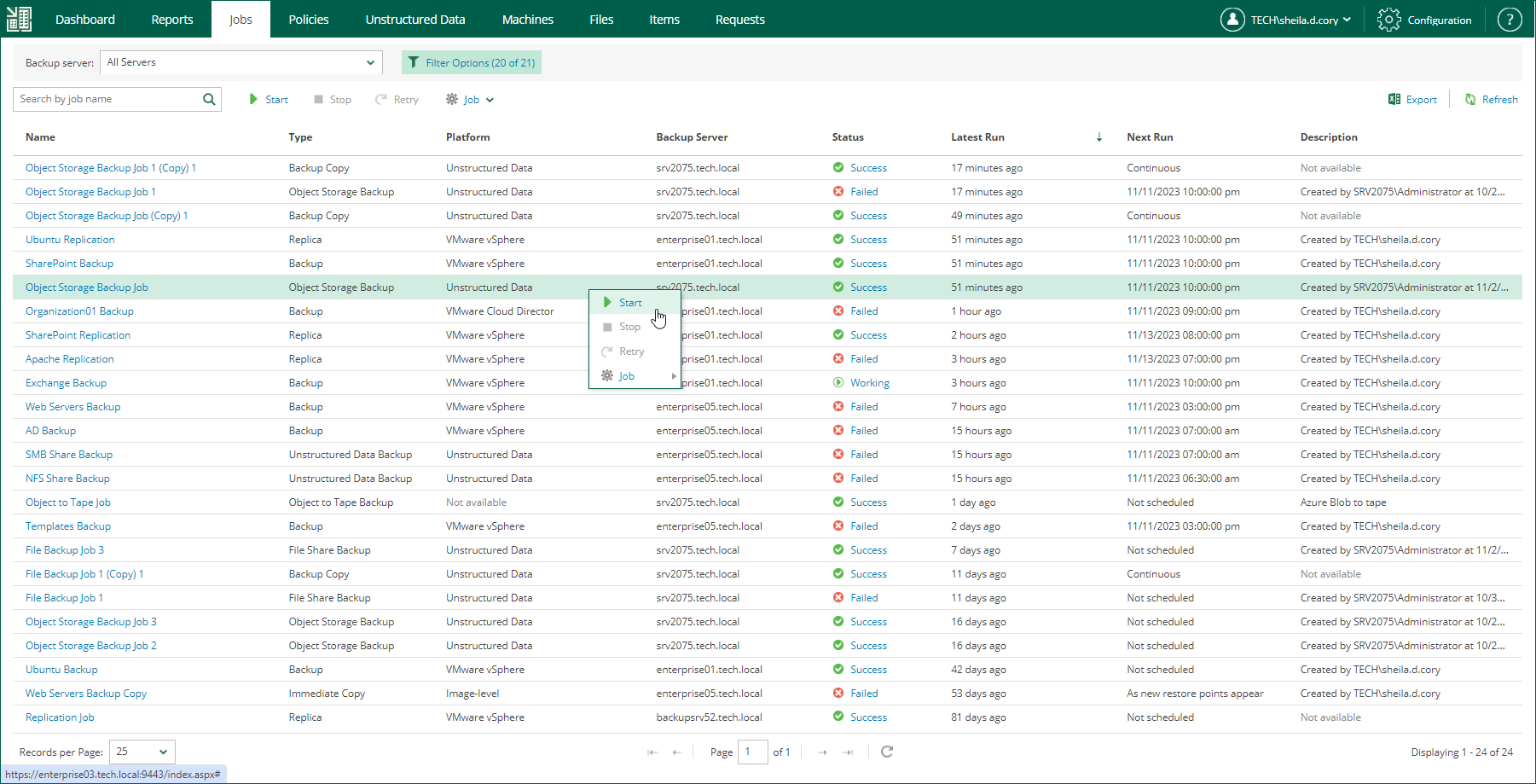

Users with the Portal Administrator role can control backup and replication jobs without the need to access the Veeam Backup & Replication console on the backup server.
On the Jobs tab, you can start, stop or retry a job.
  • To start a job, select the job from the list and click Start.
  • To stop a job, select the job from the list and click Stop.
  • To retry a failed job, select the job from the list and click Retry.
Starting Job
