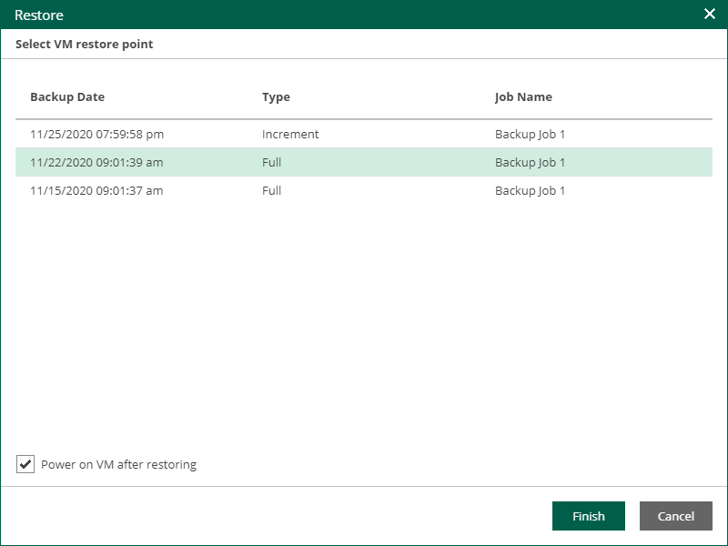

  1. Select the restore point that will be used to restore the vApp.
  2. [Optional] To start VMs in the restored vApp immediately after recovery, select Power on VM after restoring.

  1. Click Finish.
  2. Click Yes in the message window to confirm the operation.
