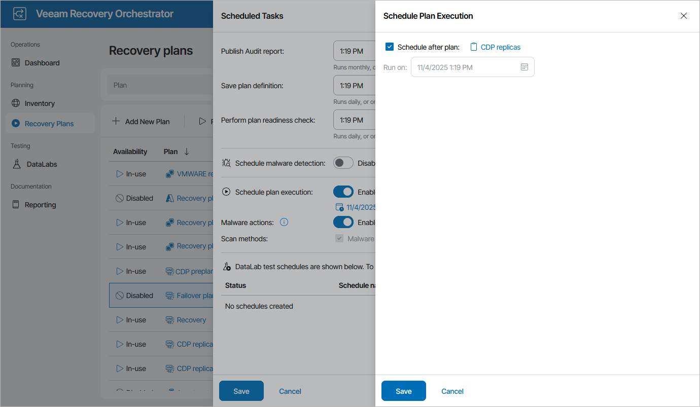

  3. In the Scheduled Tasks window, do the following:
    1. Set the Schedule plan execution toggle to Enabled.
    2. Click the Configure schedule link and choose whether you want to run the plan on schedule or after any other plan:
      • If you want to run the plan at a specific time, click the Schedule icon in the Start on field, set the desired date and time, and click Apply.
      • If you want to run the plan after another plan, select the Execute after another plan check box and click Choose. Then, in the Select Plan window, select the necessary plan and click Apply.
        For a plan to be displayed in the list of available plans, it must be ENABLED as described in section Running and Scheduling Replica Plans.
    3. Set the Malware actions toggle to Enabled if you want to check restore points created for machines included in the plan for malware flags.
      For more information on how Orchestrator performs malware scan, see Overview.
    4. Review the configuration information and click Save.
As soon as you click Save, Orchestrator will create a new schedule. To track the status of the created schedule, navigate to the Scheduled tasks tab.
