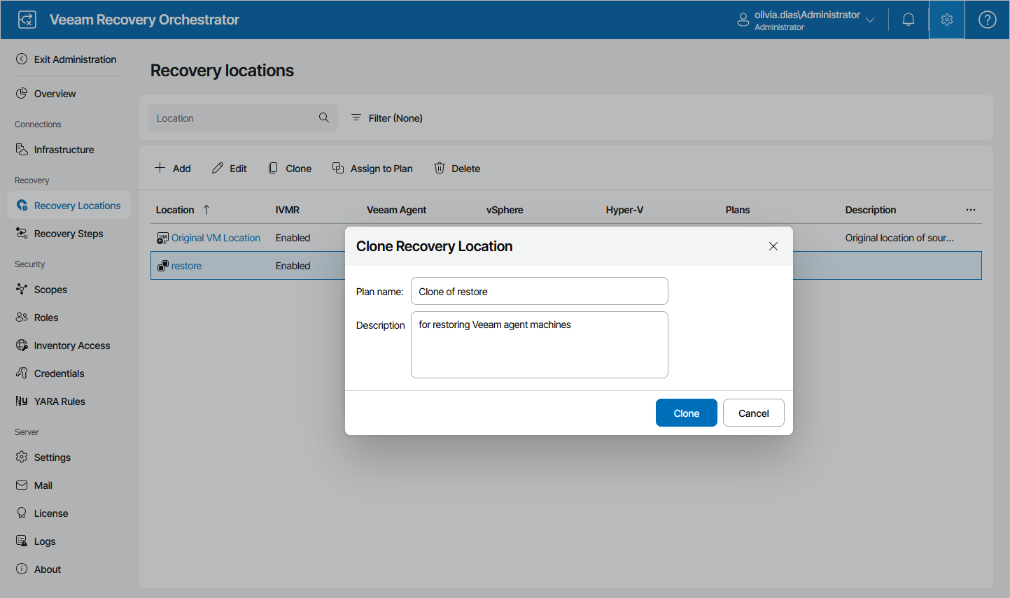

To clone a recovery location:
  1. Select an existing location that you want to use as a template for the new scope and click Clone.
  2. In the Clone Recovery Location window:
    1. Enter a name for the new location and provide a description for future reference.
      The maximum length of the scope name is 128 characters; the following characters are not supported: * : / \ ? " < > | .
    2. Click Clone to save the location.
