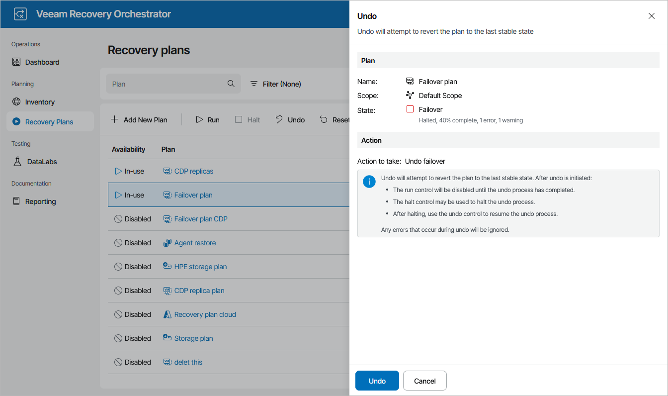

To perform an undo operation for a HALTED CDP replica plan:
  2. Select the plan and click Undo.
  3. In the Undo window, do the following:
    1. For security purposes, retype your password and click Next.
    2. Review configuration information and click Undo. The failover process will be started.
Undoing Halted Plan
If a plan repeatedly enters the HALTED state due to misconfiguration or changes in the external environment, the only option left may be to RESET the plan.
