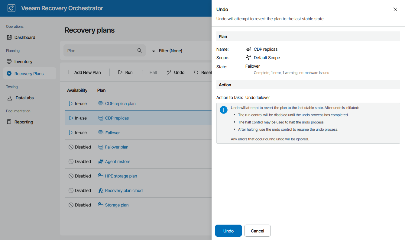

To perform an undo operation for a plan in the FAILOVER state:
  2. Select the plan and click Undo.
  3. In the Undo window, do the following:
  1. For security purposes, retype your password and click Next.
  2. Review configuration information and click Undo.
Undoing Failover
If the undo failover process encounters an error while being performed, it will not be halted automatically — the plan will proceed until the process completes. To terminate the undo failover process manually, use the Halt option to stop the currently running plan as described in section Halting Failover. To resume the undo failover process again, use the Undo option.
