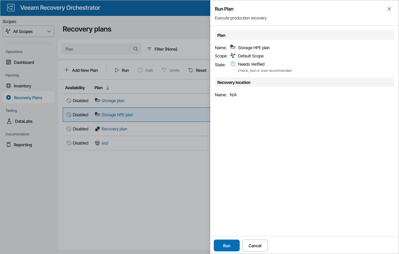

To run an HPE storage plan:
  2. Select the plan and click Run.
  3. In the Run Plan window, do the following:
    1. For security purposes, retype your password and click Next.
      You must also select the Force-enable the plan check box if you have not enabled the plan yet.
    2. Review configuration information and click Finish.
For HPE storage plans, the Run Plan wizard does not offer you to choose a restore point that will be used to recover VMs. By design, Orchestrator will always use the most recent replicated data. This is a limitation of HPE storage systems.
