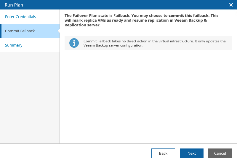

Committing Failback
  1. At the Commit Failback step, review the description of the commit failback process.
Committing Failback
