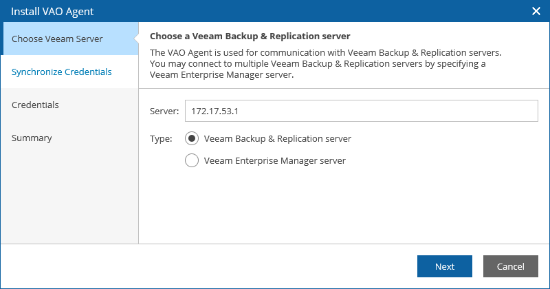

- At the Choose Veeam Server step, in the Server field, enter a DNS name or an IP address of the server where you wish to deploy the VAO agent.
Use the Type option to specify whether the server is a Veeam Backup & Replication server or Veeam Backup Enterprise Manager server.
If you choose the Veeam Enterprise Manager Server option, VAO agents will be deployed to all Veeam Backup & Replication servers managed by the Veeam Backup Enterprise Manager. |

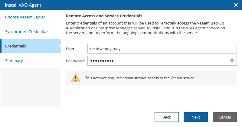

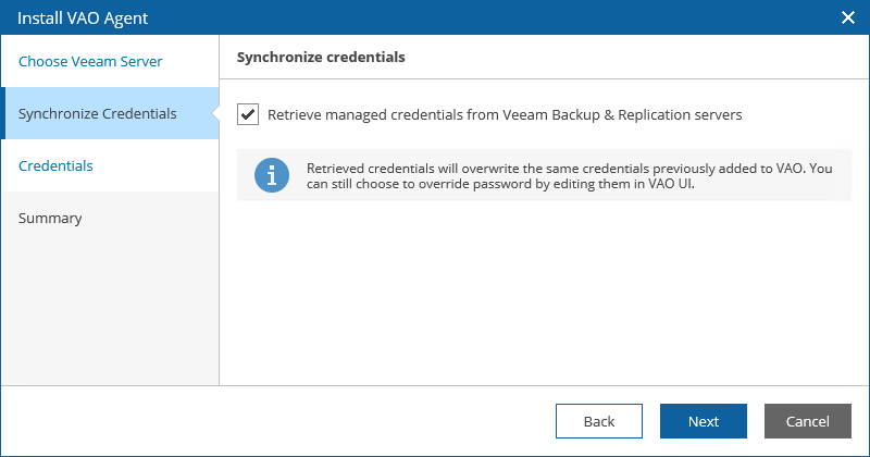

- At the Synchronize Credentials step, choose whether you want to retrieve credentials from the connected Veeam Backup & Replication server. You will be able to use these credentials later when configuring failover and restore plan steps.
- At the Credentials step, in the User and Password fields, specify credentials of a user account for connecting to the server. The provided credentials will be also used to launch the Veeam Orchestrator Agent on the server.
The user name should be specified in the DOMAIN\USERNAME format.
