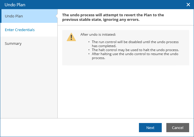

  1. At the Undo Plan step, review the description of the undo operation.
Undoing a Halted Action

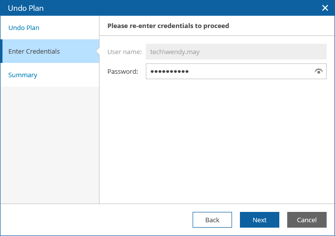

  1. For security purposes, at the Enter Credentials step, retype the VAO Administrator or Plan Author password.
