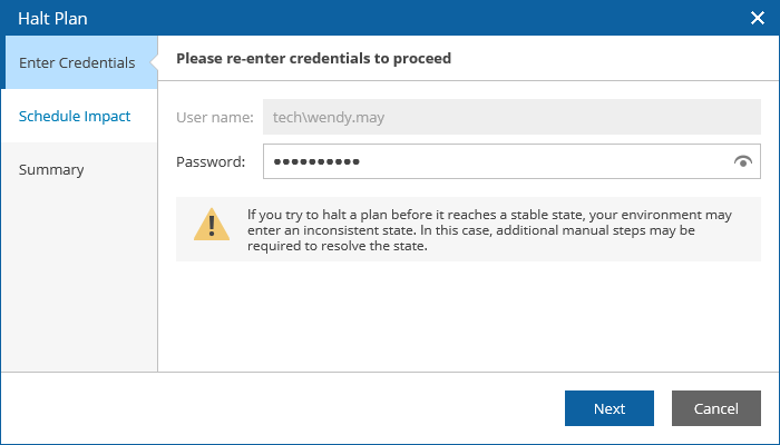

  1. Complete the Halt Plan wizard.
  1. For security purposes, at the Enter Credentials step, retype the VAO Administrator or Plan Author password.

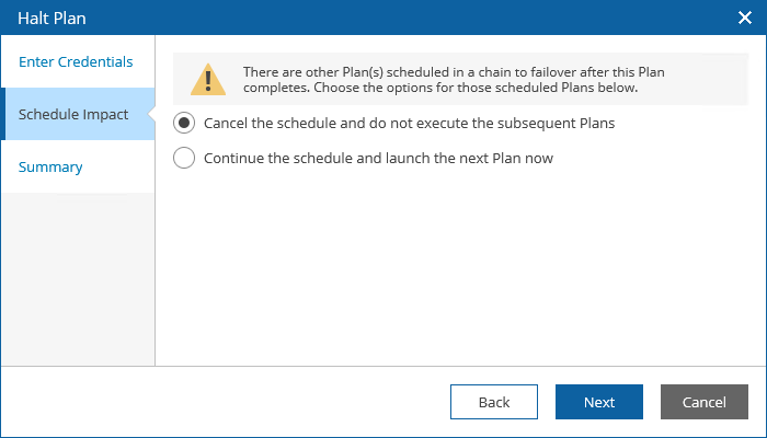

  1. [This step applies only if you have any other orchestration plans scheduled to run after the plan completes]
At the Schedule Impact steps, choose whether you want to proceed to or cancel execution of subsequent plans after the current plan enters the HALTED state.
