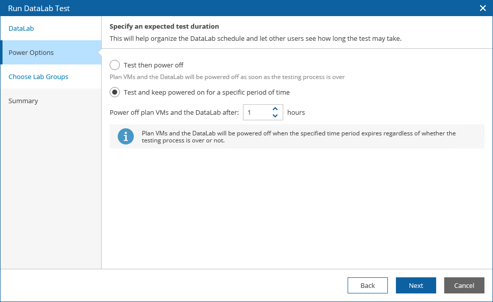

At the Power Options step, choose an action to perform after the testing process is over:
- To power off plan VMs and the lab, select the Test then power off option.
If you have selected a starting or running lab at the DataLab step of the wizard, the lab will not be powered off after the testing process is over — even if the Test then power off option is selected. In this case, VAO will power off only plan VMs and keep the lab running. |
- To keep plan VMs and the lab running in case you are willing to perform further tests, select the Test and keep powered on for a specific period of time option.
Use the Power off plan VMs and the DataLab after field to book a time slot in the lab schedule and prevent other tests from being scheduled for the same period.

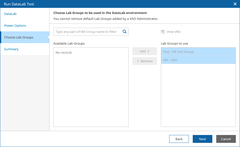

At the Choose Lab Groups step, add the required lab groups to support the test environment:
- Use the Add and Remove controls to manage previously configured lab groups.
- Use the Up and Down arrows to change the group execution order.
All default lab groups previously created by an Administrator will automatically become preselected in the Lab Groups to use list, and you will not be able to remove them or modify the order in which they will run. For more information, see Working with Default Lab Groups. |
