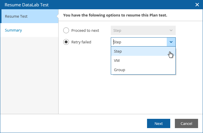

To start the HALTED failover plan testing process:
  1. Select the plan.
  2. From the Verify menu, select Run DataLab Test.
  3. Complete the Resume DataLab Test wizard.
  1. At the Resume Test step, select an option to resume test execution.
Choose whether you want to proceed with test execution from the next VM or VM group included in the plan, proceed from the next plan step, retry the failed step, retry the failed VM or VM group.
Running a Halted Failover Plan
  1. At the Summary step, review configuration information and click Finish. The testing process will be started.
