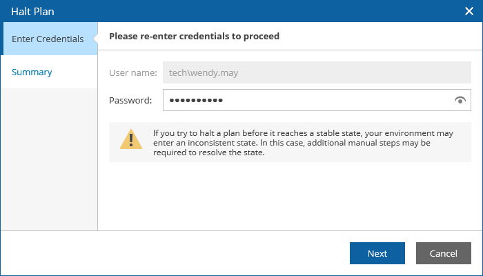

Click the plan name to switch to the Plan Details page, and click Halt.
- Complete the Halt Plan wizard.
- For security purposes, at the Enter Credentials step, retype the VAO Administrator or Plan Author password.
- At the Summary step, review configuration information and click Finish.
