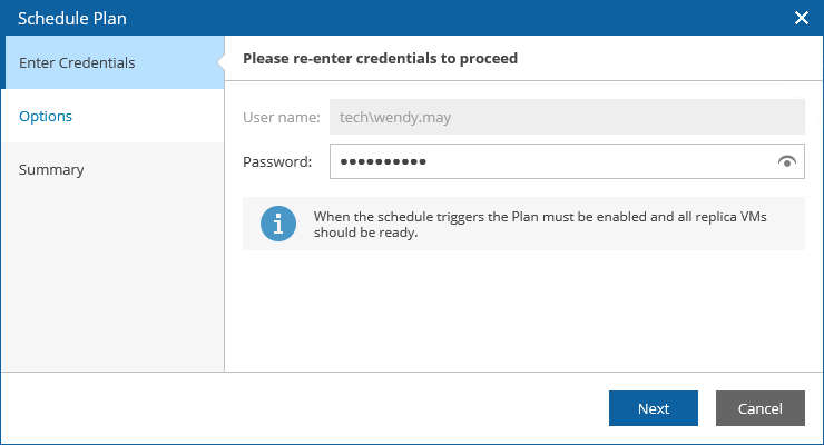

- For security purposes, at the Enter Credentials step, retype the VAO Administrator or Plan Author password.

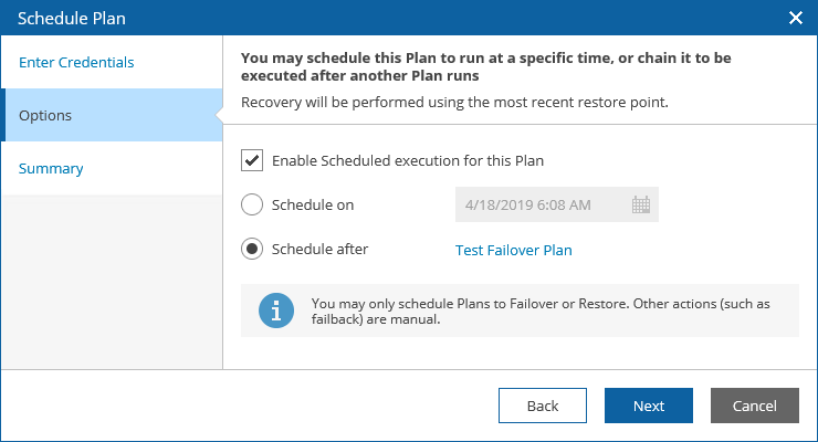

- At the Options step, select the Enable Scheduled execution for this Plan check box, and choose whether you want to run the plan on schedule or after any other plan.
If you want to run the plan at a specific time, select the Schedule on option and choose the date and time.
If you want to run the plan after another plan, select the Schedule after option and choose the preceding plan.
- At the Summary step, review configuration information and click Finish.
