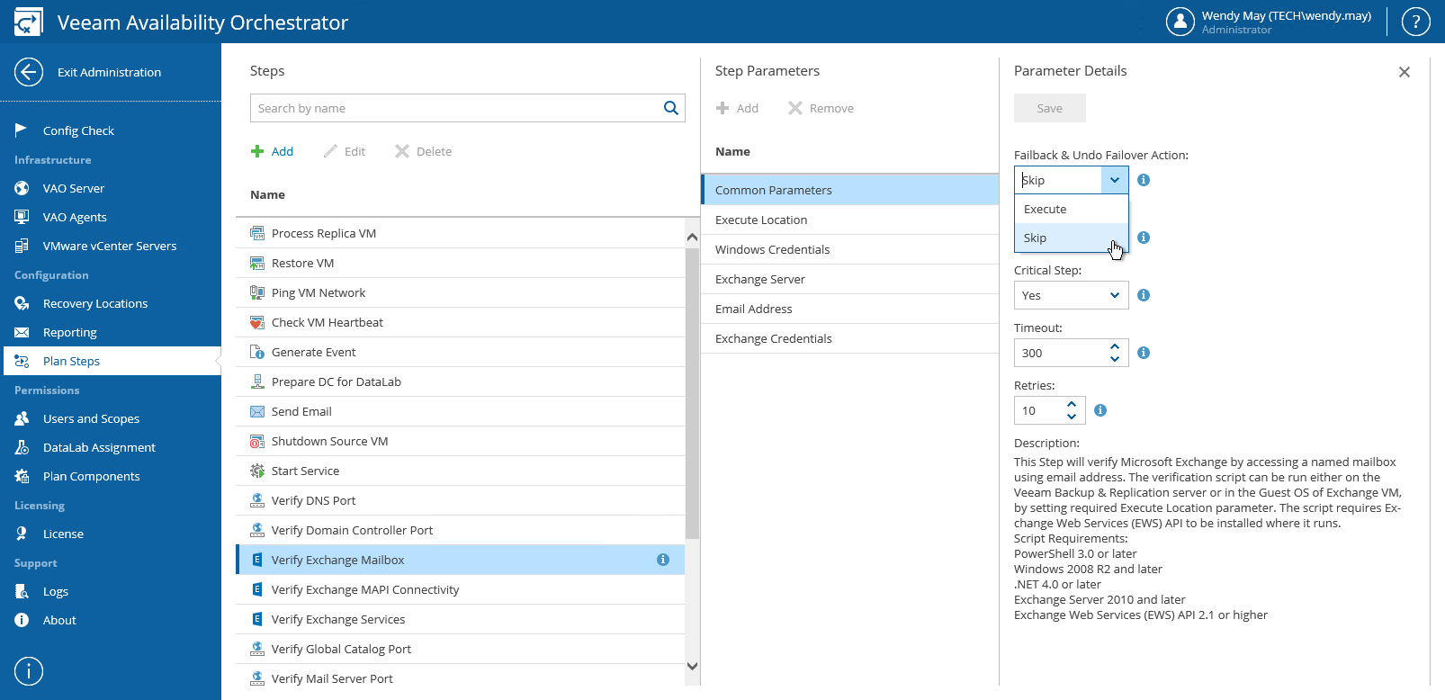

To modify default parameter settings for a plan step:
- Log in to the VAO UI as a VAO Administrator. For details, see Accessing VAO UI.
- Switch to the Administration tab.
- Navigate to Plan Steps.
- Select the step.
- In the Step Parameters column, select the required parameter.
- In the Parameter Details column, set the desired parameter values and click Save.
In the Save Default Parameter Values window, decide whether you want to apply the configured settings to all plans created for all scopes at the same time. To do that, select or clear the Globally push the new default values into all Orchestration Plans in all Scopes check box. Note that the parameter settings will be changed only for plans that are not in the IN USE mode. For the list of modes that an orchestration plan may acquire, see Running and Scheduling Failover Plans and Running and Scheduling Restore Plans. |
