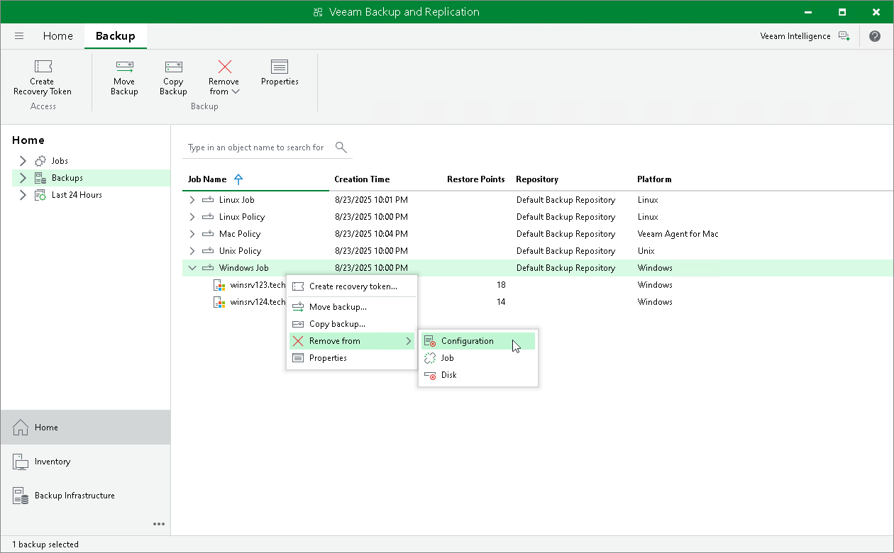

To remove a Veeam Agent backup from configuration:
  1. Open the Home view.
  2. In the inventory pane, click Backups.
  3. In the working area select and remove the necessary backup:
  • To remove the entire backup related to the Veeam Agent backup job or policy, select the backup, press and hold the [Ctrl] key, right-click the backup and select Remove from > Configuration.
  • To remove a backup of a specific computer in the Veeam Agent backup job or policy, expand the parent backup, select the necessary computer, press and hold the [Ctrl] key, right-click the computer and select Remove from > Configuration.
