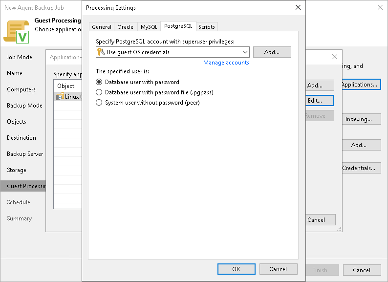

To specify how Veeam Agent for Linux must process the PostgreSQL database system, perform the following:
  1. At the Guest Processing step of the wizard, click Applications.
  2. In the Application-Aware Processing Options window, select the necessary object, click Edit, then click the PostgreSQL tab.
  3. On the PostgreSQL tab, specify a user account that Veeam Agent for Linux will use to connect to the PostgreSQL database. You can do one of the following:
  • Select from the Specify PostgreSQL account with superuser privileges list a user account that has the required rights for the database.
If you have not set up credentials beforehand, click the Manage accounts link or click Add on the right to add credentials. With this option selected, Veeam Agent for Linux will connect to the PostgreSQL database under the account that you have selected in the Specify PostgreSQL account with superuser privileges list.
Keep in mind that if you plan to select the peer authentication method at the step 4 of this procedure, you can add a user account in the Credentials Manager without specifying the password for the account.
  • Select the Use guest OS credentials option.

  1. In the The specified user is field, specify how Veeam Agent will connect to the PostgreSQL database.
The The specified user is field is connected closely with the Specify PostgreSQL account with superuser privileges list. Veeam Agent will do the following depending on what you specified using these two controls.
