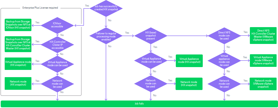

Transport Mode Selection for HyperFlex version 4.5(2a) or later
Configuring Backup Proxies

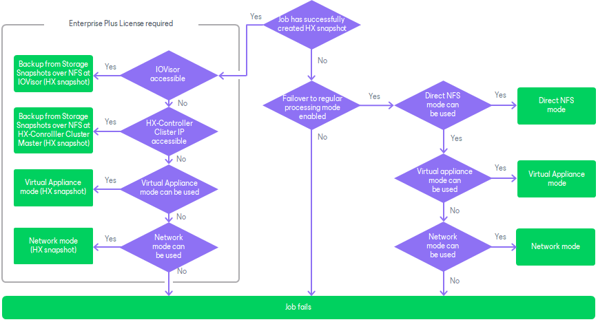

Transport Mode Selection for HyperFlex version Before 4.5 (2a)
