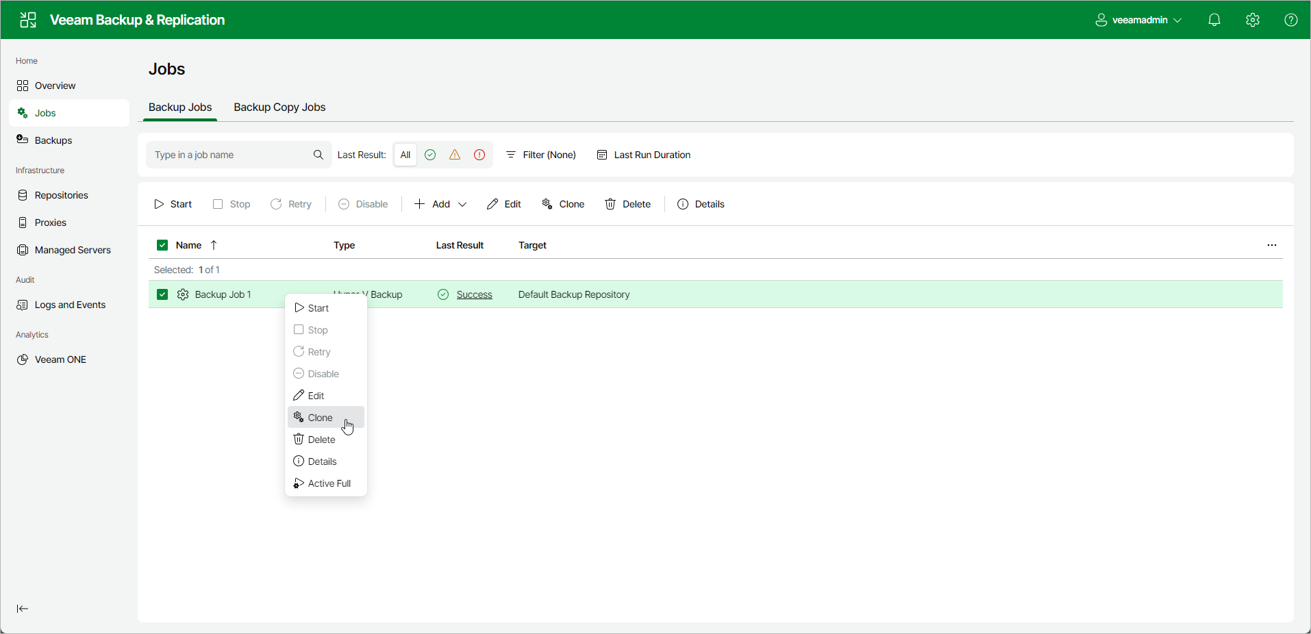

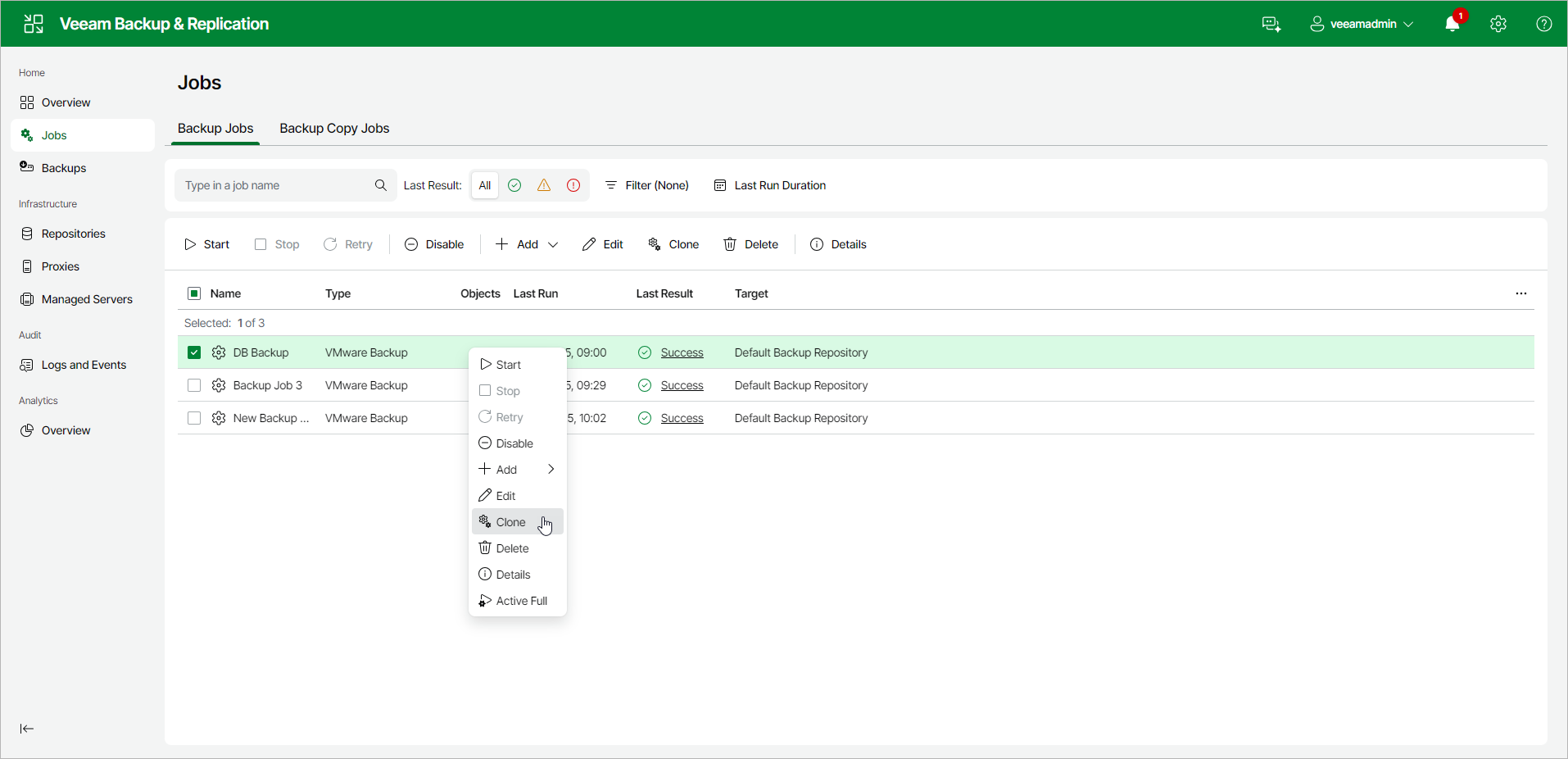

To clone a job:
  1. In the management pane, click the Jobs node.
  2. In the working area, select a job and click Clone on the ribbon or right-click the job and select Clone.
  3. After a job is cloned, you can edit all its settings, including the job name.
