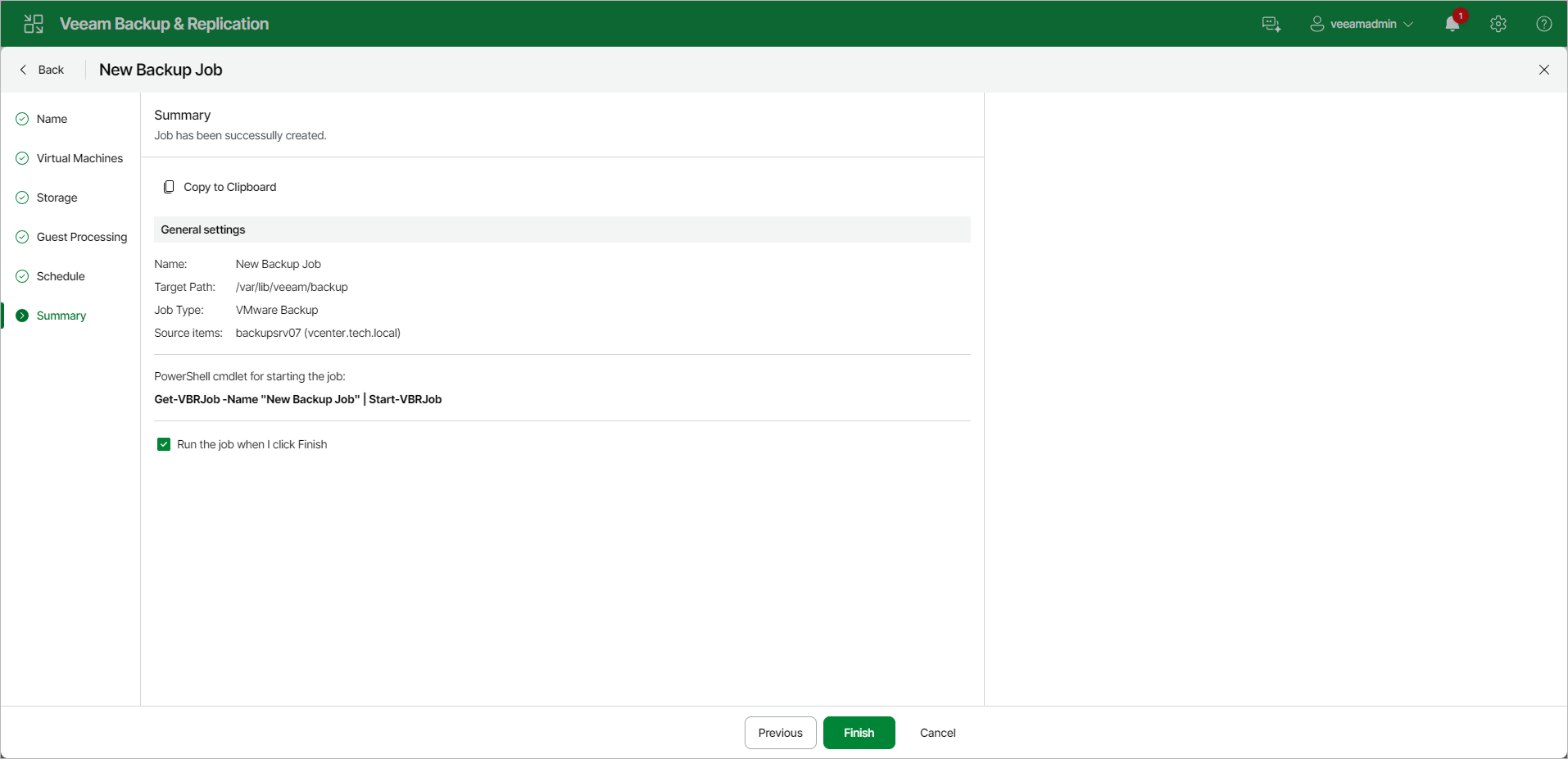

Step 10. Finish Working with Wizard
At the Summary step of the wizard, complete the procedure of backup job configuration.
  1. Review details of the backup job.
  2. Select the Run the job when I click Finish check box if you want to start the job right after you finish working with the wizard.
  3. Click Finish to close the wizard.
