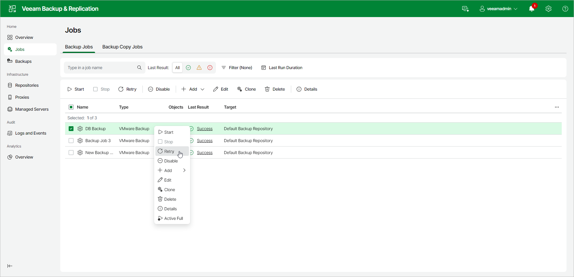

To perform retry for all workloads in a backup job:
  1. In the management pane, click the Jobs node.
  2. In the working area, select a necessary job and click Retry on the ribbon. Alternatively, you can right-click the job and select Retry.
Retry an individual job
