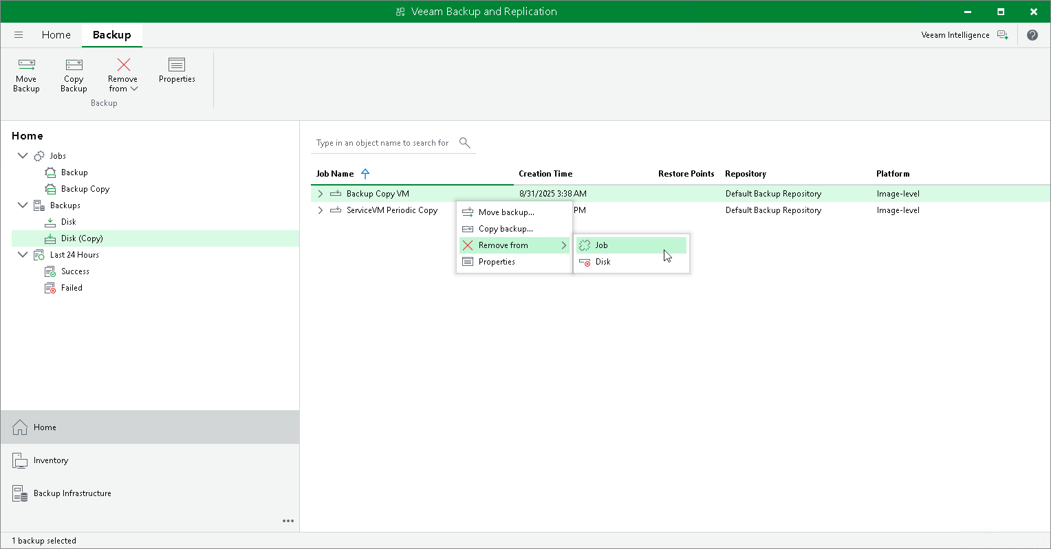

Detaching from Job
When you detach backup copies from a backup job, the job stops processing these backup files. During the next run, the job will start a new backup chain, that is, will create active full backup.
Veeam Backup & Replication detaches the whole backup chain including GFS backups. The detached backup files remain in the backup repository and also in the Veeam Backup & Replication console. Veeam Backup & Replication shows the detached backups in the inventory pane in the node with the (Orphaned) postfix. These backups are retained according to the background retention process. For more information, see Background Retention.
To detach backups from a backup copy job:
  1. Open the Home view.
  2. In the inventory pane, select Backups > Disk (Copy).
  3. In the working area, right-click the backup copy job and click Remove from > Job.

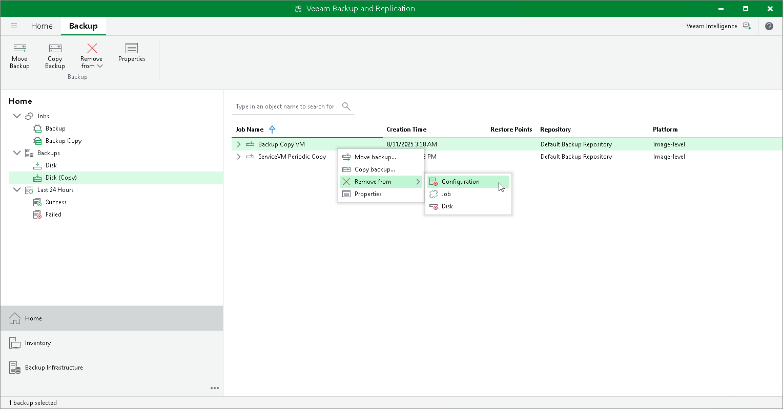

Removing Backups from Configuration
Removing backups from configuration is designed for experienced users only. Consider using Detach from job or Delete from disk operations.
Create encrypted configuration backup before removing backups from configuration.
When you remove a backup from the configuration, backup files remain in the backup repository. You can import the backup to Veeam Backup & Replication at any time later and restore data from it.
When you remove an encrypted backup from configuration, Veeam Backup & Replication removes encryption keys from the configuration database. If you import such backup on the same backup server or another backup server, you will have to specify the password or unlock the backup with Veeam Backup Enterprise Manager. For more information, see Importing Encrypted Backups.
To remove a backup from the configuration:
  3. In the working area, press the [Ctrl] key, right-click the backup that you want to remove and select Remove from > Configuration.
