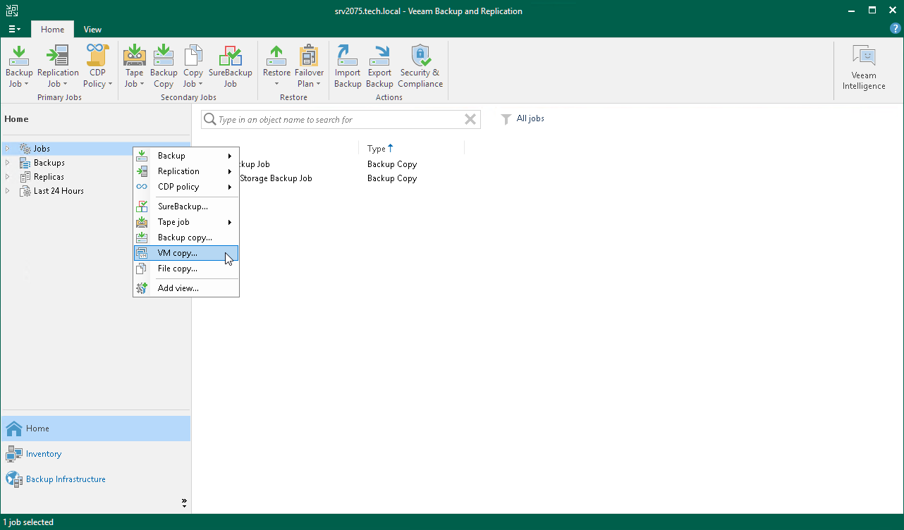

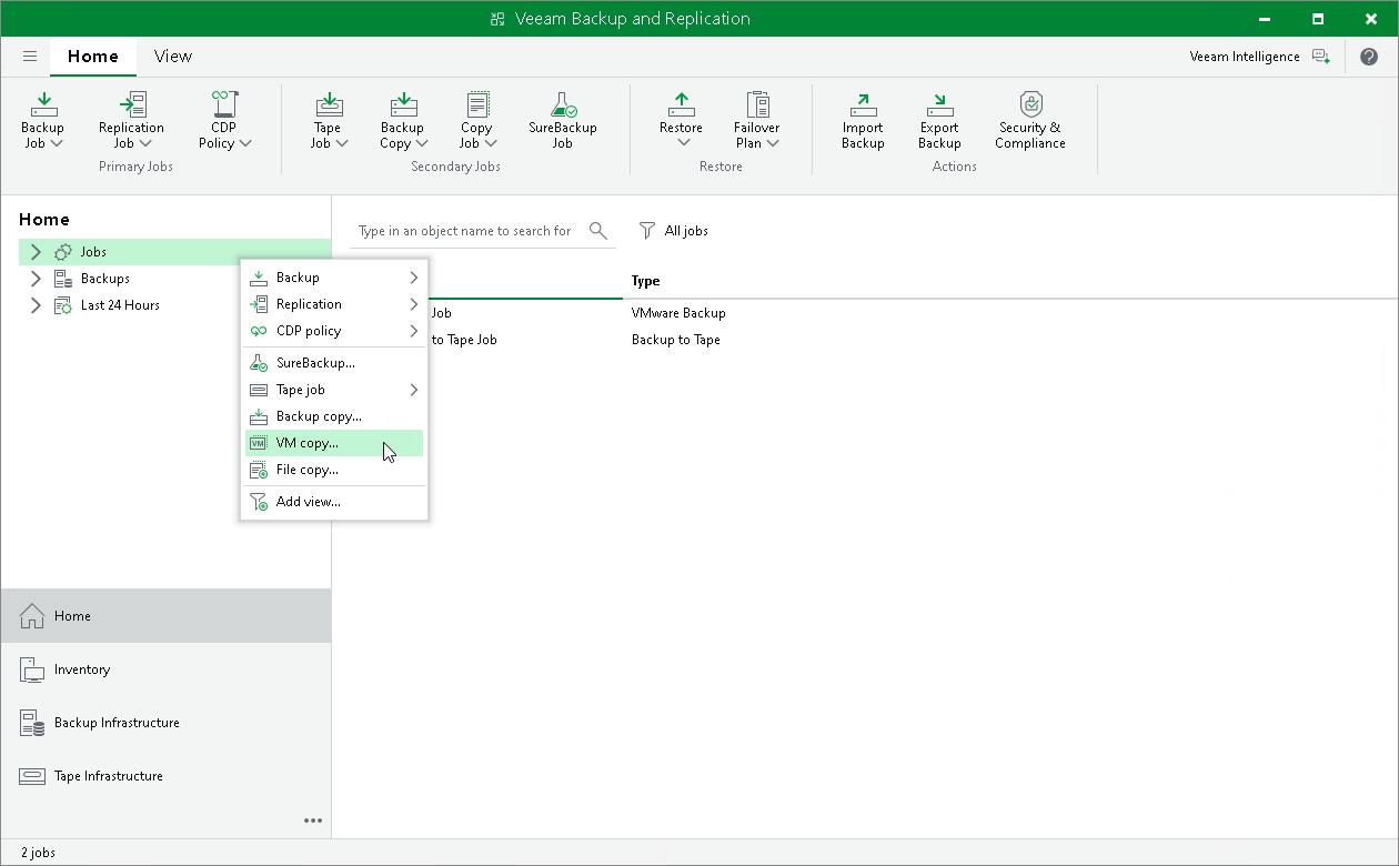

Step 1. Launch VM Copy Job Wizard
To run the VM Copy Job wizard, do either of the following:
  • On the Home tab, click Copy Job > Virtual machine.
  • Open the Home view. In the inventory pane, right-click Jobs and select VM copy.
