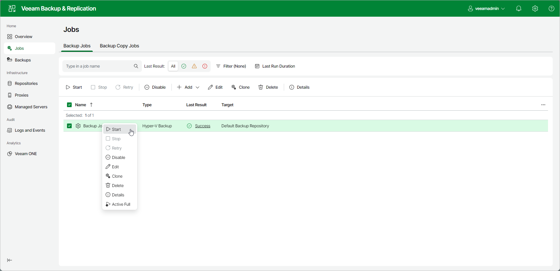

Starting Jobs
To start a job:
  1. In the management pane, click the Jobs node.
  2. In the working area, select a backup job and click Start on the ribbon or right-click the job and select Start.

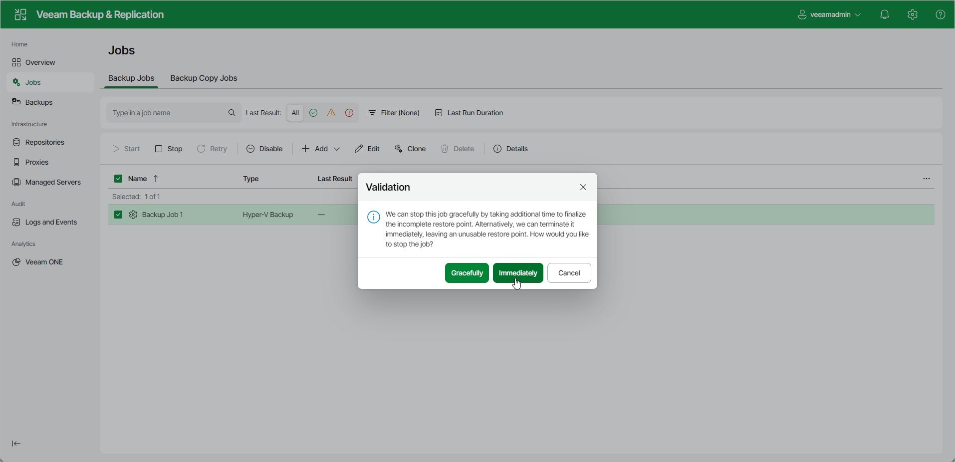

Stopping Jobs
You can stop a job in one of the following ways:
  • Stop the job immediately. In this case, Veeam Backup & Replication will produce a new restore point only for those VMs that have already been processed when you stop the job.
  • Stop the job after the current VM. In this case, Veeam Backup & Replication will produce a new restore point only for those VMs that have already been processed and for VMs that are being processed at the moment.
To stop a job:
  2. In the working area, select a backup job and click Stop on the ribbon or right-click the job and select Stop. In the displayed window, click Immediately.
To stop the job after the current VM:
  2. In the working area, right-click the job and select Stop. In the displayed window, click Gracefully.
