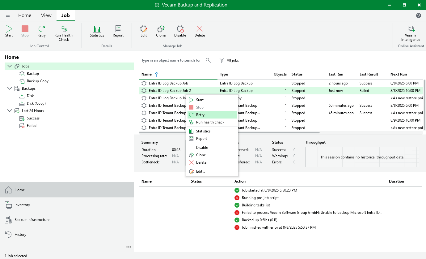

To perform retry:
  1. Open the Home view.
  2. In the inventory pane, select Jobs .
  3. In the working area, select the necessary job and click Retry on the ribbon. Alternatively, you can right-click the job and select Retry .
Retry Job
