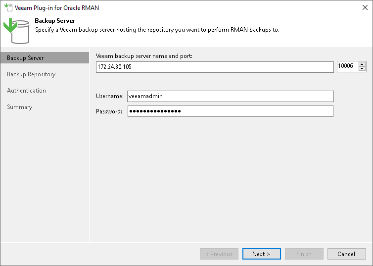

  3. At the Backup Server step of the wizard, specify the DNS name of the Veeam Backup & Replication server and OS user account credentials that will be used to connect to the server.

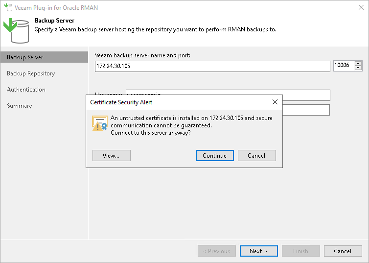

  1. If you connect to the specified Veeam Backup & Replication server for the first time, Veeam Plug-In displays the Certificate Security Alert window. After you review the certificate, click Continue to confirm the connection.

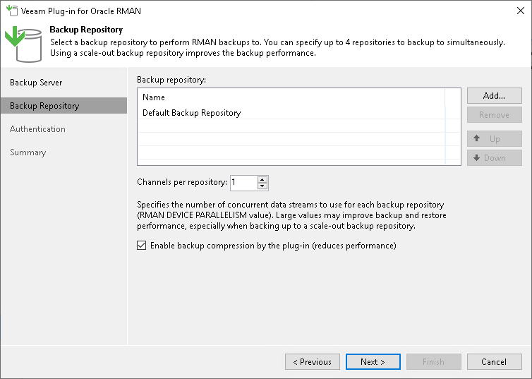

  1. At the Backup Repository step of the wizard:
  1. Click Add and select the required repository. For Oracle Database Standard Edition, you can select only one repository. If you want to use the Oracle RMAN Backup Duplexing functionality, you can select up to four repositories. The copies of backups will be sent to all selected repositories.
You must allow access to Veeam backup repositories that you plan to use. To learn how to configure access permissions on repositories, see Access and Encryption Settings on Repositories.
  1. If you want to use another repository, select the repository from the list and click Remove. Then, you can add another repository.
  2. At the Channels per repository field, specify the number of allowed parallel data streams for each repository.
  3. If you want to enable Veeam Plug-In compression, select the Enable backup compression by the plug-in check box.
Note that if you use Veeam Plug-In compression in combination with Oracle RMAN integrated compression (BACKUP AS COMPRESSED commands), it can slow down processing.
  1. Click Next.

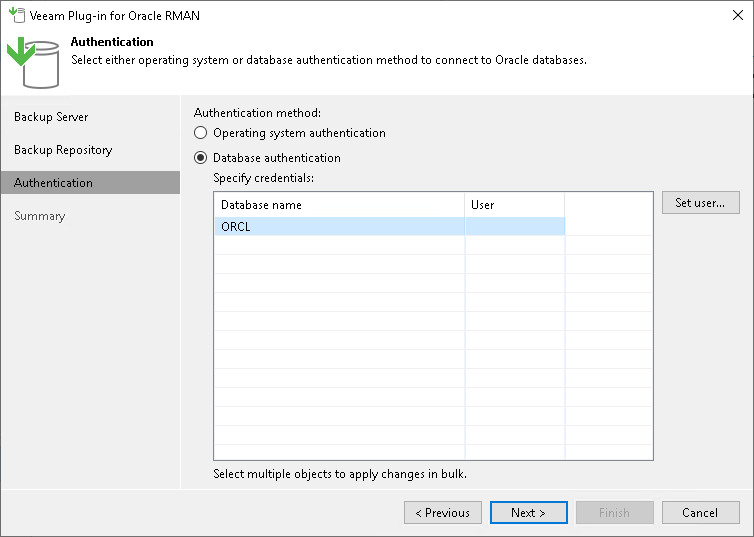

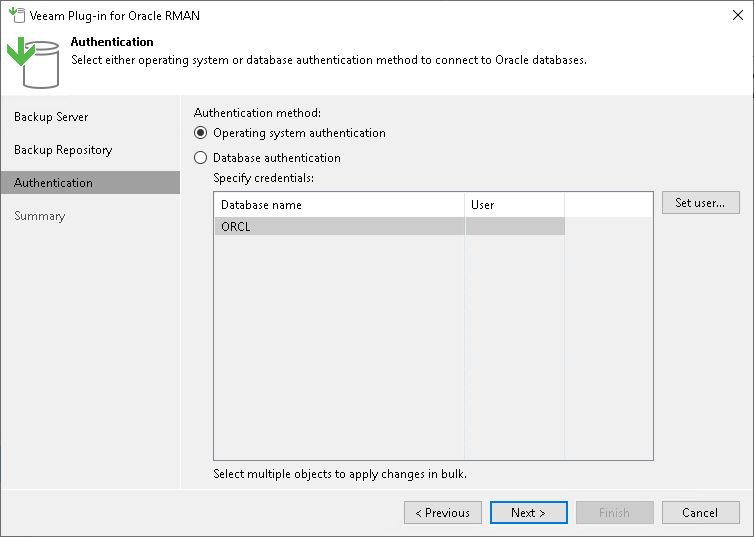

  1. At the Authentication step of the wizard, you can select a preferred authentication method to connect to the backup database.
You can choose between the operating authentication and database authentication methods. With the OS authentication method, you can connect to the server and database using OS user credentials. With the database authentication method, you can connect to the server using OS user credentials and to the database using database user credentials. The OS user account must be a user on the Oracle server with the required permissions to run RMAN.
If you select the database authentication method, you must specify the database user account credentials. The OS user credentials are applied automatically.
Note that the Veeam Plug-In configuration tool changes the settings of Oracle RMAN. All original settings of Oracle RMAN are saved in the %PROGRAMFILES%\Veeam\VeeamPluginforOracleRMAN\RMANParameters.xml file.
For details, see Authentication Against Database.
  • Select Operating system authentication, to choose the OS authentication method.

  • Select Database authentication, to choose the database authentication method.
You can configure credentials for each of the target databases or one set of credentials for multiple databases. You can update all database credentials using the OracleRMANConfigTool command, if needed. The list of set credentials is stored in the veeam_config.xml configuration file.
By default, the database user account must have the SYSDBA permission on the database. To learn more about Oracle permissions, see this Oracle article. With Oracle Database 12c, you can also authenticate with a user account that has the SYSBACKUP privileges. To learn more, see Authentication Against Database.
To set database credentials, perform one of the following:
  • Select an individual database and click Set user to configure the database user account credentials.
  • Select multiple databases and click Set user to configure common credentials for multiple target databases.

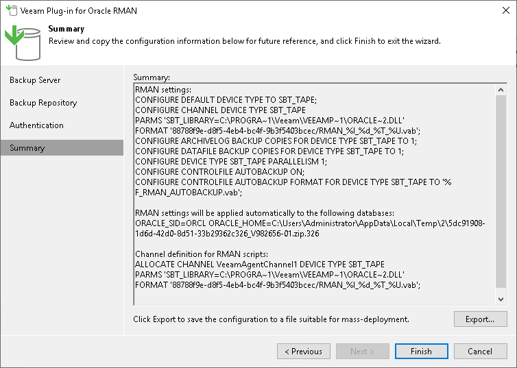

  1. At the Summary step of the wizard, you can export the plug-in and Oracle RMAN configuration files. You can use the configuration files to apply the plug-in settings on other servers.
  1. To export the veeam_config.xml file click Export and select Veeam Config.
  2. Click Finish.
Configuring Plug-In on Microsoft Windows
When you export the configuration files, Veeam Plug-In automatically enables Oracle's Controlfile Autobackup feature. This feature is required for restoring with different settings using Veeam Explorer for Oracle.
It is recommended to save the configuration files, so that you can use it as a reference. For example, if you are planning to manually allocate channels for backup and restore operations, you will need the repository UUID. The RMAN configuration file (rman_config.txt) contains an example for channel allocation definition for the target repository. You can use this statement in your backup/restore scripts.
