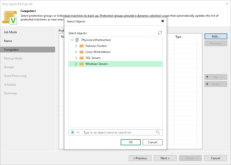

Adding Protection Groups and Computers from Inventory
To add protection groups and individual computers to the Veeam Agent backup job, do the following:
  1. Click Add > Protection group.
  2. In the Select Objects window, select one or more protection groups and computers in the list and click OK. You can press and hold the [Ctrl] or [Shift] key to select multiple objects at once.
To quickly find the necessary object, use the search field at the bottom of the Select Objects window.
  1. Enter the object name or a part of it in the search field.
  2. Click the Start search button on the right or press [Enter].

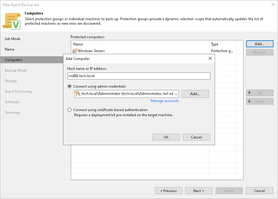

Adding New Computers
To add to the Veeam Agent backup job new computers that do not exist in the inventory, do the following:
  1. Click Add > Individual computer.
  2. In the Add Computer window, in the Host name or IP address field, enter a full DNS name, hostname or IP address of the computer that you want to add to the job.
  3. Select a method to connect to the computer:
  • Connect using admin credentials. In this case, select a user account that has administrative permissions on the computer that you want to add to the job. If you have not set up credentials beforehand, click the Manage accounts link or click Add on the right to add credentials.
  • Connect using certificate-based authentication. Select this option, if you chose to pre-install Veeam Installer Service on the computer that you want to add to the backup job. In this case, Veeam Backup & Replication will communicate with the computer using a certificate. To learn more, see Deploying Veeam Agent Using Veeam Deployment Kit.
After you complete the backup job configuration, the added computers will appear in the Manually Added protection group. To learn more, see Predefined Protection Groups.
